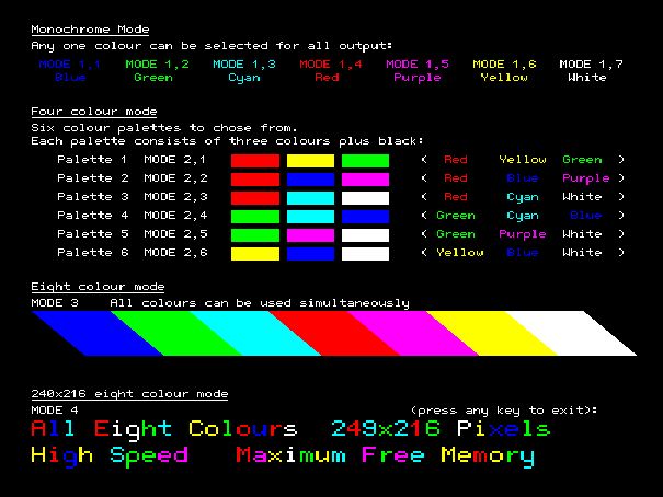

  Geoffg said   I thought of colour coding the text for the full screen editor but then I realised that the editor needs as much memory as it can get. As a result the editor now switches to monochrome when it loads (this frees up the memory) and then on exit switches back to whatever colour mode the user had set (there are four modes; monochrome, 2-bit colour, 3-bit and 240x216 3-bit).

I'm a bit confused. I thought 2-bit and monochrome are essentially the same (monochrome meaning 1 colour from the Greek words mono=one chrome=colour).
Is there even a need for monochrome/2-bit? Apart from memory usage, MMBasic programs not written for colour should be oblivious to the different mapping. Unless colour commands are used, the default colours should be Black and White anyway.
Also, doesn't the larger 100 pin Pic32 have more memory?
Maybe we only need 2 modes... 480x432x8(colors) and 240x216x8(colours).
240x216 would still be suitable for most applications while consuming half the memory of the 480x432. And I think colour would be the desired mode to work in when you consider that every VGA monitor connected to the Maximite is colour.
I can see that the editor could get in the way though. Shame.
1-bit colour (one bit per pixel) = one colour (monochrome)
2-bit colour (two bits per pixel) = four colours
3-bit colour (three bit per pixel) = eight colours
The more bits use up more memory but eight colours still leaves a lot. Monochrome and 240x216 uses the same amount of memory for the video as the mono Maximite running 3.x does.
Nop, it just has more I/O pins.
This is what the modes look like at this time (this could easily change as development progresses). The colours look beautiful on the screen, it is a pity that they have lost something in this image:
Note that when you change modes the whole screen changes, this demo was fudged with the screen in MODE 3
Geoff

  Nick said   So, does that mean...
1 bit colour = 8 displayed pixels per byte
2 bit colour = 4 displayed pixels per byte
3 bit colour = 2 displayed pixels per byte + 1 unused bit
No, each colour has its own memory area (25920 bytes each in 480x432 pixel modes) so there is no wasted memory. You can dynamically switch modes as a program is running and as you do that memory will be automatically allocated or freed to accommodate the number of colours dictated by the mode.

So 2 maps? One for the pixel information (8 pixels per byte?) and another color map area?

  Gizmo said  GIF's are better suited to images with detail, like circuits, code, etc, and less than 256 colours
Thanks, hopefully this will look better...
Remember that this is a work in progress, anything can change.
Geoff

  Nick said   So 2 maps? One for the pixel information (8 pixels per byte?) and another color map area?
No, one "map" for each colour (assuming a "map" means the memory for each colour). Each colour has its own memory area and SPI driver and stream of pixels. They are independent of each other but because each stream of pixels is clocked identically they combine on the screen into eight colours.
