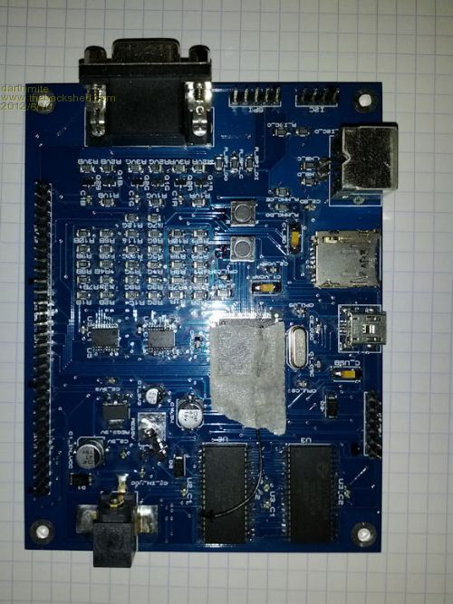

darthmite
Joined: 20/11/2011
Location: France
Posts: 240
Posted: 08:40am 10 Jun 2012
Ha oki i see your point
My point was to have a system who can handle more resolution and colours.
Just with one DMA and PMP , no SPI at all are used.
For internal memory solution it's allot more easy and cost less to build.
Actually i made a card with external SRAM + R2R DAC and level converter to
be able to put it on a VGA screen.
But ... i made some mistake in the conception and now i wait up i get the
new PCB , then it will be again the hell to solder all little smd components
Here is a photo from the actual design.
After checking if the new design is OK i have to understand correctly
how the DMA / PMP work with the SRAM and video generation ...
And for this , the microchip examples are not really helping me
Cheers.
