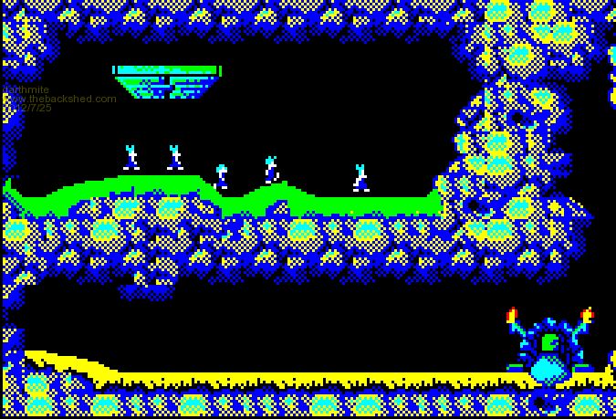

Heya
The beta test continue !
This time i use bmp ,Sprites , Amiga music modules and ... Blitter
Everything at same time for see if it's stable.
I converted a original Lemmings level for the Maximite and load
it as bmp at start.
I don't have manage to get the real colours but for a test it will be OK
In the video you will see that the screen up down movement is very smooth !
ColourMM test 2
Here a picture.
And here the source code for those who want see how i made the demo.
2012-07-25_110448_SPRITES3.zip
Cheers.
PS : Sorry for my Frenglish language in the video Edited by darthmite 2012-07-26

Fabulous!
This shows the power of the new MMBASIC in regards to games and what you can do with so little interpretive BASIC code.
The only thing is the flickering of the software sprites. Have you got a delay between the SPRITE ON and OFF commands?
Unfortunately, I haven't got a Colour capable Maximite yet so I can't run any tests but I would look into keeping the SPRITES ON and avoid as much SPRITE OFF time to minimise the flicker.
This may mean, rather than erasing all of the sprites at once, then updating their positions all at once, then finally turning on the sprites all at once... instead, do them one at a time. Each sprite should be turned OFF, moved, then turned ON individually.
I'm only guessing since I haven't looked at your code in detail but this was a problem I mentioned to Geoff when I was explaining to Geoff the operation of the software SPRITE commands.
I can't wait to get my hands on a Colour Maximite!

I tell this to Geoff too , he will look at new command i have propose to
no more have a flicker sprite.
The thing is that i have to put the sprites off for check if i have a active pixel at left or right from each sprite to decide the direction they have
to run.
Because this is done in the time the sprites are off it take some time that made
the flicker effect.
The new commands i have propose to Geoff are TestPixel(x,y) who return the
pixel color BUT who will ignore it if it is a sprite pixel.
The 2nd command is a Animate command that will automatically draw a sprite from a
animation set.
It's like Sprite Move but for animation .
So , with the normal Sprite Move they are no flicker because the command erase the
sprite and redraw it directly to the new position.
The Testpixel combined to the Animate command can be a easy solution.
Geoff will soon hate me
Each time i send him a mail is for made it work more
And Nick , prepare your MaxMan for colour , it's a must have m8
Cheers.
PS : And don't forget that this is a beta version (who work great) Edited by darthmite 2012-07-26
