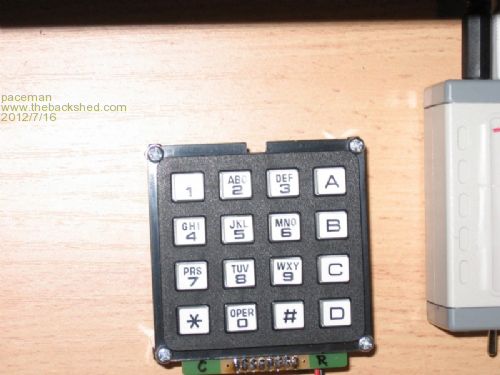

I decided to try Jez's technique but using a 4x4 keypad to allow some spare keys to use for other functions e.g. menu, delete, navigate etc.
The physical setup is shown below and the keypad is a $29 version from Jaycar (I'm sure there are plenty of others available for a lot less than that though).

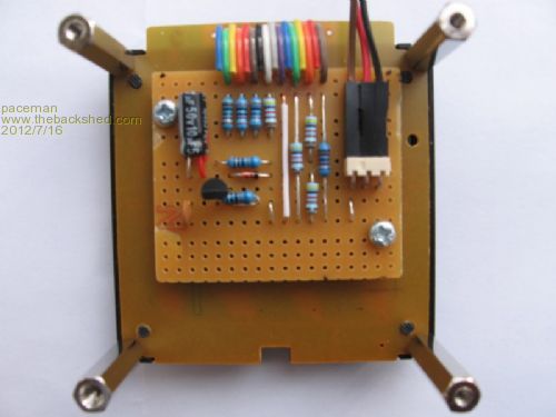

I had to change Jez's analogue "board" resistances and the constant current setting of the LM334Z constant current device to obtain good spread for all 16 keys across the 3.3v available to be read by the Maximite. Supply voltage for the keypad needs to be 5v as used for the 4x3 keypads. The resistors used were 1K,2K,3K,4K for the columns and zero,4K,8K,12K for the rows, giving a 1K to 16K matrix in 1K steps (nice and simple). Some of the resistors are non-standard values but all were in stock at Rockby and delivered in two days.
The LM334Z constant current source ($1.50 or thereabouts from Jaycar) was set at 0.190mV (actually 0.189) using 680 ohm & 6K8 ohm resistors, maintaining the 1:10 resistance ratio recommended in the National Semiconductor datasheet to obtain minimal temperature dependance. I didn't have a 1N457 diode (as recommended by NS) so substituted a 1N4148 which seems to work well. (Incidentally, Jez's schematic shows a 1N547A which I think is probably a typo.)
The analogue parts were soldered to a small piece of proto board which can be seen in the second photo. The header holes on the keypad board were connected to the proto board with a short piece of 16 conductor ribbon cable (every second conductor is at 0.1" spacing which gives a neat connection). Ground, 5.0v supply and analogue signal out, were connected using a 3 pin right-angle male polarised connector which is convenient to connect to female jumper wires and then later to a permanent plug for a project. The proto board was attached to the keypad with two short M3 screws which screwed to 5mm lengths of threaded plastic standoff Super-glued to the keypad board.
