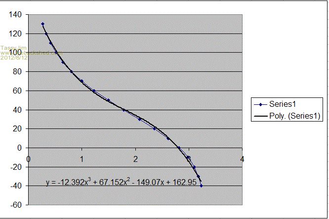

Posts: 6620
Posted: 02:05pm 11 Aug 2012
The first step is to convert the resistance values into voltages.
With a 1k resistor from 3.3V to the sensor and the other side of the sensor to ground, the table is:
T R V
-40 45313 3.228745709
-30 26114 3.178291657
-20 15462 3.099538331
-10 9397 2.98260075
0 5896 2.821461717
10 3792 2.611352254
20 2500 2.357142857
30 1707 2.080938308
40 1175 1.782758621
50 834 1.500654308
60 596 1.232330827
70 436 1.001949861
80 323 0.805668934
90 243 0.645132743
100 187 0.519882056
110 144 0.415384615
120 113 0.335040431
130 89 0.26969697
I then put this into a chart in Excel and get a trendline.
A third order polynomial gives a close match:
The formula is on the chart.
This is usually close enough given the likely accuracy of the sensor and the MMbasic 10bit ADC.
For automotive use, I would put some protection between the sensor and the Maximite. There are a lot of nasties floating around under the bonnet.

jman
Joined: 12/06/2011
Posts: 711
Posted: 09:58pm 11 Aug 2012
Many thanks for the reply's
I have been using an orginal Maximite in the car for a few months now
with no issues at all. With a small switchmode PSU for the 5V regulator
@Mick
I tried you method and it works just fine.
I used ohms law to get the resistance from the measured volt drop
across the 1k resistor.
@Jim
Your table is great and after a little fiddling with Excel i came up
with this Temperature = (-12.392 * (engtemp^3))+(67.152*(engtemp^2))-(149.07*engtemp) + 162.95
This seem to work pretty well.
once again thanks for the help
