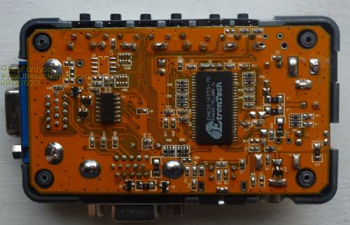

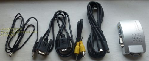

Got the VGA-Video adapter today, very quick delivery! Here's what I got.
As promised I've opened it up, with the back cover off you see this. The big chip is some SDRAM.
There must be a video encoder chip on the other side, and sure enough;

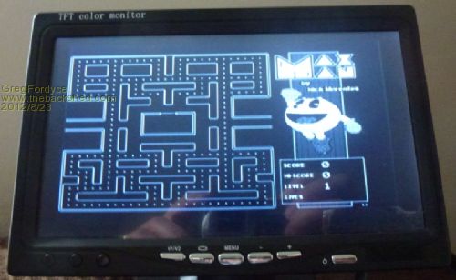

So how's it work? Well I only have an original MM, but here is MAXMAN on a small 7 inch lcd screen.
So it seems to do all I want it to do, and Frank has already said it works with his CMM. I plan on using either large fonts or mode 4 for a user interface so the small size of the standard fonts won't be an issue.
I suppose if the MM genie granted me one wish, it would be to have the option of larger fonts while using the full screen editor for quick changes to code without having to connect a vga monitor or laptop to get a readable editor screen.
Overall I am quite pleased with the results and quite impressed with what I got for 12.50GBP.
EDIT: the SDRAM is a EtronTech EM636165 and the encoder chip is a VX1937, datasheets availible on google.Edited by Greg Fordyce 2012-08-24

Thanks very much for the pictures and test!
It is great! The 'expensive' ones that use the frame technology are finally cheap. :)
I ordered two with VGA to Video converter on ebay. Only US$12.56 a piece and free shipping.
