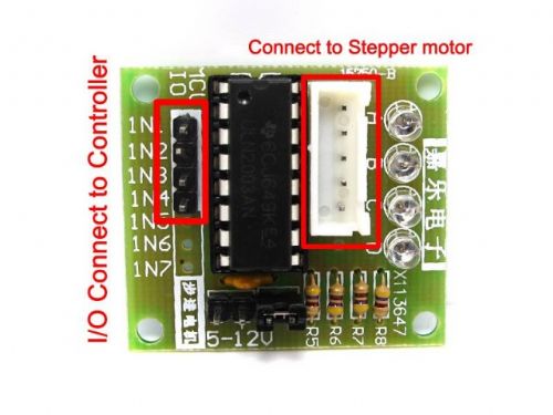

Hi all, I'm Maria from Sweden and new to micro controllers but eager to learn. :)
Have a DuinoMite Mega and some ULN2003 stepper motor drivers and a couple of unipolar (five wires) stepper motors from scrapped scanners/printers. Problem is, I'm not sure where to put current on the stepper motor driver, so thought I ask if any of you could help. I attach photo of the driver so you see it.
I suspect i should put either 5v or 12v on either of the terminals labelled so, and leave the unused one jumpered as is, but to afraid to just test it in case it fries my DuinoMite.
(have another DuinoMite still boxed if this one fry)

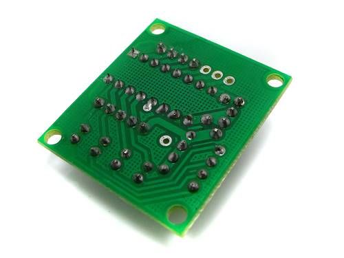

edit: Perhaps the back with all traces are good to include. :)
edit again: sorry, disregard all this, I see now it says 5 to 12v... How embarrassing... Pretty tempted to delete this post now... Well... Edited by mariae71 2012-08-23

Hello Maria,
take a look at:
http://ssecganesh.blogspot.de/2008/05/driving-stepper-motor- using-uln2003.html
Frank

Much thanks for the link Frank,
I managed to get the driver to output signal in the right sequence and the motor to spin, but I think two or more pins between the driver and motor is in wrong place, because motor sometimes misses steps or run a bit jerky... Awesome with the leds on the driver so one can see the sequence... :)
The illustration on the link you provided should be a great help to put wires in right order on the motor. :) Edited by mariae71 2012-08-23

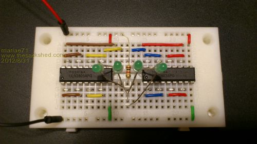

Also ordered a stack of ULN2003 chip, since I fried one of the transistors in one of the chips... Might be able to use the chip anyway if I modify the card and exchange the traces, but, it really does not matter, because 7 ULN2003 chip only cost around 1€ from my supplier. Might be able to use the broken arrays to control some relays instead. :)
Also read somewhere that one can stack two or three ULN2003 on top of each other to increase the amperage tolerance, can someone confirm this?

it is not a good choice to stack different ULN2003 together. ...but it is possible to increase the allowable current with shorting two outputs of one ULN2003!
Different ULN2003 have different transistors with different values and different temperatures - you will get a unequal current through the transistors!
One output must deliver more current than the other!
The transistors in one ULN2003 have the same tolerances and aprox. the same temperatur => you can shorting two or three outputs (and inputs) from the same ULN2003 to increase the allowable current!

  mariae71 said   But if I stack four identical ULN2003 ontop of each other, or is every ULN2003 from same type and batch different? Because the ULN2003 only have 7 transistors i cannot short the pins on one chip to double since i need 8 transistors to do that.
The better choice would have been the ULN2803 which has 8 sections. Much easier then to parallel two sections for double the output.

Posted: 07:57pm 26 Aug 2012
Ron P
Nice! I ordered a couple of those the other day... :) Also, on a Piezo Driver card from an old broken huge Howtek printer that got slaughtered for rare electronics, I found four ULN2823A, seems to have 8 transistors as well... Other nice stuff on that card is 32 variable resistors, four 10K resistor arrays and four chips called SN74LS24N.
Still planning to test all other suggestions in this thread, I just have to learn a bit more first. I'm very grateful for all help and advice... Thanks! :)
edit: spelling...
edit2: If anyone is interested about what's happened so far... This is a photo of the proto one I made with two ULN2803, with 4 sections in parallel per lead, very satisfied with it, stays room tempered all the time with 12V 650mA, and should handle at least 2A...
