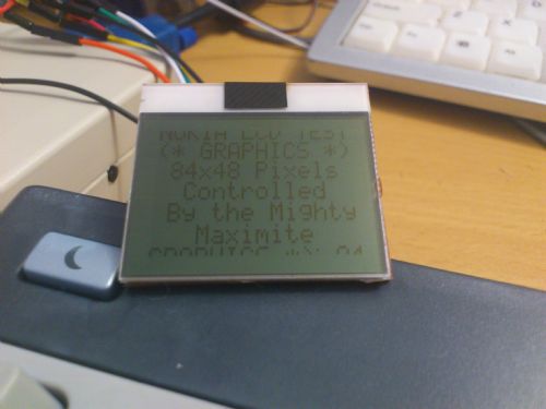

Posted: 02:45am 28 Aug 2012
Thank you guys, I now have it running, had to convert my DuinoMite Mega into a Maximite and to test your code jman. :)
Two problems is however apparent.
1) Text does not fit vertically on screen (top and bottom line is cut off), the 3310-screen is smaller than the 5110 screen?
edit: I now see that it's the vertical offset that is off rather than the screen height, top half of the first text line appears at the very bottom.
2) The screen is very dim - no back light? edit 2: managed to find out how to increase the constrast.
Added photo, this is how the text appears on the screen:
Edited by mariae71 2012-08-29

Well... After pulling my hair all day and night, the problem is no more. :)
seems there is different (at least two) drivers on those screens, and also that the driver is for screens that are 102x67 in resolution, and all that space is writeable. Solution is to shift the display up 5 pixels and start writhing at row 1 instead of row 0.
Found out about it all on this old forum post:
Nokia 3310 LCD shows only 5 rows of byte-wide pixels
After reading the initializing code in C on page two i added the instructions to the screen that was missing and awesomeness was instant. :)
Thanks very, very much for the code example jman. :)
