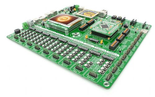

Well, I said it few times - develop on PIC24 and burn the final application on PIC32.
Mikroelektronika did it:
Edited by vasi 2012-08-30
Elvish name: Mablung Miriel
Beyound Arduino Lang
Posts: 4386
Posted: 12:20am 29 Aug 2012
It's rather expensive!!

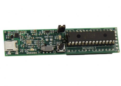

You could just use the Microchip Microstick II. It even comes with a PIC24F, PIC24H, dsPIC33 and PIC32 DIP and built in programmer/debugger. All for $35. Plugs right into a breadboard.
Wish these PIC32 DIPs had enough memory to run Maximite.
There are so many simple, small, easy to kit/build gadgets you could create with a Maximite DIP chip.

Of course I don't have money for that board but if it is to be 100 pin PIC24/32 development board, then it has to be that board. No compromises.
For complex applications and for commercial applications this board is great.
For DIP packages I will rater stay with PIC18F/ATmega, at 5V, as I'm doing it already.

The totaL cost for the Fusion v7 Pic Development "Kit" which includes the PIC32 micro adapter and software for only $440 USD. Too steep for my wallet.
One thing I did noticed is their top secret, advance technology "Mikro bus" which they said "covers 80% of interfacing requirements" A hacker could install an Olimex Arduino proto shield on top of the Color Maximite, add two 8 pin headers on the shield and use MikroElektronka's assorted 31 Click boards on the Color Maximite. The only unknown is whether SPI is available on the Arduino shield pins on the Color Maximite ??? Maybe GeoffG can chime in on this question.
