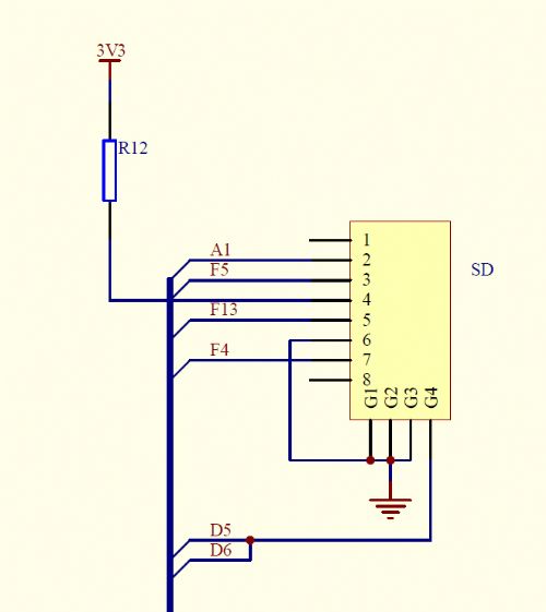

Posts: 2981
Posted: 01:47pm 28 Sep 2012
TZ,
I have wired the microSD as per the cct here (using correct uSD pin numbering conventions) for my UBW32 to CMM adapter PCB (I have the PCBs now and am trying to get time to build and test it but work/family keep getting in the way).
Please excuse my lazy method of schematic drawing as I didnt get time to create a nice uSD layout for Protel 99se.
The socket I chose (element14/Farnell P/N 1355805) also has a switch for card inserted (G3 and G4) ..... G1 and G2 are just the casing and really for mounting...
As there is no write protect switch on the uSD I linked both the the WP signal and the card Inserted signal together (probably should have used a low value resistor between them but its too late now.)
I have tested the pinout and the logic of my switch on my UBW32 and it works ok.

MicroBlocks
Joined: 12/05/2012
Location: Thailand
Posts: 2209
Posted: 01:08am 29 Sep 2012
Mick,
Thanks a lot!
I got it working first try with this info. :) :)
