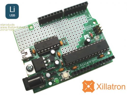

Not bad...Bit worried about that capacitor next to the pic32 though...
looks like an ordinary electrolytic where a 10 uF metallised/ceramic
should be (?). It is changed in other photos (to a tag tantalum ?)
BTW the 28-pin pic32's run at half the speed, so I'd expect a speed hit.

Is there a schematic Chuck?
Just trying to work out the function of the second I.C.
Perhaps I missed the obvious.

Appears to be USB controller chip

None that I could find.
The second PIC is for the USB to Serial that the FTDI chip performs on the chipKIT board.
The PIC32MX1 doesn't have onboard USB but the PIC32MX2 does have USB on board so that would have made the design simpler. Maybe that's a next generation?

I could read the part number on the chip as PIC16F1455. This is one of the new USB parts that don't need an external crystal to run USB. It's called clock recovery.
PIC16F1455 feature:
Universal Serial Bus 2.0 Module with clock recovery from USB host.
So I'm sure it's doing the FTDI function.

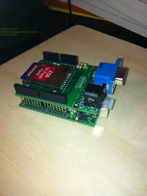

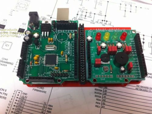

I thought the same thing when the PIC32 DIP parts were released but even before that I produced a few prototypes that I called the Maximino based on the original Maximite to see if there might be interest in this type of module for MMBASIC, but I couldn't get much interest in the thing. I even made a plugin shield for the keyboard, VGA and SD card.
Maybe someday I'll just open source it and let people smarter than me figure it out. It's also where I learned that the Vcap needs to be surface mount to get the required low ESR. Frankly, I hate surface mount for my projects. I'm still old school and prefer leaded everything.

I am guessing here but - the xillatron first photo
seems to have an leaded electrolytic capacitor, and the further
photo seems to have a leaded tag tantalum capacitor instead.
I get the impression they are not the low ESR usually needed ??
The dspic33f at 40 mips certainly need the low esr. Microchip boards
tends to use small format 0805 Murata / Panasonic smd ceramics, I
have settled on the larger size 1206 equivalent which are much easier
to handle,

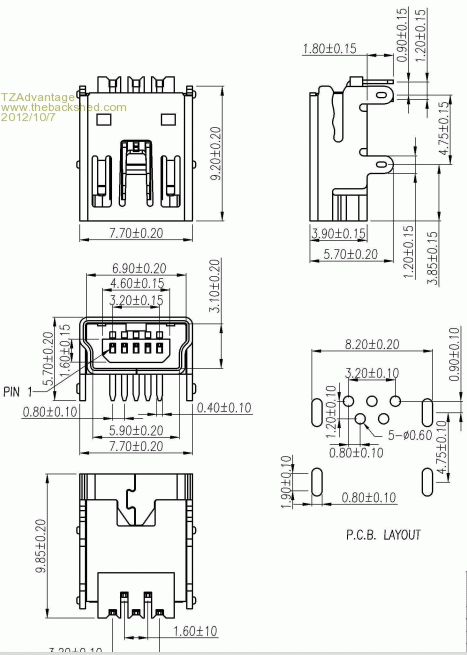

chronic also just pointed out to me that the mini-usb used could be a through hole type. I checked and you can see the pads on the solder side of the board artwork, so they are through hole.
I'll almost bet these won't be easy to get for many users, and the standard BM should have been used. After all, the profile is lower in height than the DC connector.
Don...

I looked back at his board layout and see that you are right, it is leaded.
I learn something from you guys everyday.
I never knew a leaded version of that mini USB connector existed.
This is great.
Digikey doesn't list any but Mouser has one that they list as a new product.
Details at the link below.
Great catch guys.
I have several designs this can be used in.
