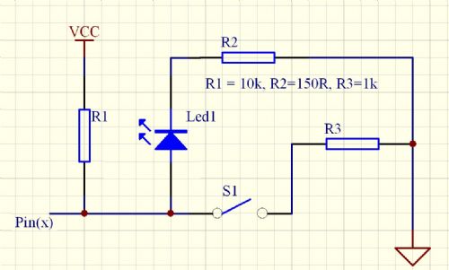

Hi John,
Can you try my TESTER3.Bas program?
2012-10-14_185056_tester3.zip
It requires my Test-A-Mite to run fully but you can duplicate this cct to test the Pin(1) only.
Then you can test Digital output and Digital Input..
This is how I tested your code. I am wondering if it may be configured for Open Collector output by mistake as my cct would still work if that was the case but a simple LED/Resistor may not.
Have you buzzed out the cct to neighboring pins looking for shorts?

Posted: 07:31pm 14 Oct 2012
Hi John,
I just tried my UBW32 Colour MM and Pin(1) to see if it might actually be configured as Open Collector.
I just put an LED across GND and Pin(1), no pullup, and it works well so it must be configured correctly.
If you have flashed the correct MCC firmware into your boards I would lean towards a problem in your drive cct for your relays... and maybe it JUST works on the mono-MM by a whisker and is just lucky..

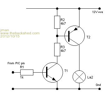

I have now tried you circuit and software and I get the same result.
Yip it is the correct firmware Colour works perfectly
I re-flashed the PIC just in case same result.
If I measure the voltage on pin(1) it always stays low the other pins go up to 3.3V as expected
Circuit below
one other observation if I read the pins as analog pin1 reads 0v
the other pins2-10 read 1.4v
Starting look like the PIC's are faulty but both ?

Posts: 2981
Posted: 07:58pm 14 Oct 2012
Hi John,
I cant fault that circuit... It SHOULD work so there must be something else wrong

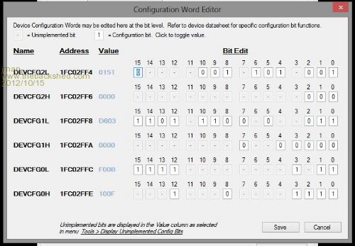

If you have access to a pickit3 try flashing in this HEX file (which is the one I used on my UBW32) it was emailed to me directly by Geoff.
2012-10-15_055646_ColourMM_MMBasic_V4.0.zip
It may be that a config bit has been set incorrectly..
I am not really an expert with the programming of the Pic32 using the PicKit3 but I have done it several times. I know there are some config bits but i havent played around with them.

Posted: 08:30pm 14 Oct 2012
Hi Mick
Yip device is correct
Here is a screen shot of the config bits
Only odd thing is I am using a Pickit 2 to do the programming
once again thanks for all the help
jman
Joined: 12/06/2011
Posts: 711
Posted: 08:52pm 14 Oct 2012
We have a WINNER
I re-programmed the PIC using Pic32prog and now pin(1) works perfectly
config bits maybe ?
Thanks for all the help
