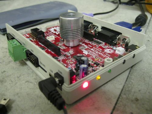

I have a maximite running all day every day, its doing a fair bit of work, and it does get warm, but not too hot that I cant put my finger on the Pic32. The regulators have heatsinks fitted, and these get a bit to hot for comfort, I might look at making them bigger. I'm running 3.2.
I agree we may need to look at ways to fit a little heatsink to the chips. The problem is mounting it.
I dont think we need a big heatsink, something the size of a thumb nail with fins would be enough, like you would fit to a TO-220 regulator thats not working to hard.
I'm wondering about the heat transfer capabilities of superglue? Is there a heat transfer compound thats also a glue?

small heatsink and fan often there is a suitable one on old vga cardsEdited by djuqa 2012-10-17

I know Don Recardo had this problem with V3.2, and his immediate solution was:
However he was ordering some self adhesive heat sinks. Just wondering how you got on Don?
Sure since V2.7, each new version of MaxiMite has it drawing more current, as Geoff has indicated.
This appears to be the major culprit, so a simple cheap ebay solution would be nice.
Super glue? Don't know. Anyone experiencing these problems game enough to try?
I believe it must be a small percentage of PIC32s that become operationally marginal at the higher current loads.
Don...
