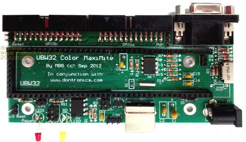

Hi, just built my colour Maximite using a UBW32 which was previously a monochrome Maximite using MMBASIC 3.2. Done all the re-wiring, flashed it with MMBASIC 4.0. works great except for the memory card, it just says "cannot access the SD card".
I've checked and re-checked all the wiring and all looks good. The SD card isn't in a socket but solded staight to wires and then to the UBW32 board, so not a socket problem. I've noticed the use of a 2.2ohm resistor on the 3.3volt line which wasn't present on the monchrome Maximite, is it possible that not enough power is going to the SD card?
I hope someone can help.
Thanks. Dave.

Sorted. Bypassed the 2.2ohm resistor and all works well.
Thanks. Dave.

Mick designed the UBW32-MCC-PCB:
http://www.dontronics-shop.com/ubw32-mcc-pcb-letter.html
and obviously noted the differences and tested it both ways:
See R12 near the SD card. He has it shorted out.
I spoke to him this morning about it. His response:
I also ran with it shorted as can be seen in the actual picture R12 just above the power jack.
So I don't think its critical.
Don...Edited by donmck 2012-10-20

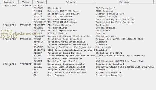

Hi Guys, I have exactly the same issue on two UBW32 MCC's which has not been rectified by shorting out R12 and am now beginning to suspect a possible issue with the fact that I used the UBW32 bootloader to load the Colour MMbasic V4.0. Both MCC`s fire up but the SD card cannot be found.
Has anyone else had this very same issue? If so, which version of the Maximite bootloader would be most preferable. By the way, I did try flashing the V4.0 software with the bootloader into the UBW32 using a Pickit3, but it would not fire up once programmed which is why I went back to the UBW32 bootloader.
Looking forward to some of your thoughts.

G'Day Guys, I did initially try flashing the file "ColourMM_plus_bootloader_V4.0.hex"
into the UBW32 using a Pickit3 and MPLAB 8.x ....but it did not come to life when powered up. After many attempts at programming the PIC, I decided to try the native UBW32 bootloader which then allowed me to load the ColourMM V4.0 file.
This then raises the question of what I was doing wrong in MPLAB? Any thoughts?
Mick you made a good point regarding potential soldering issues on the SD card socket, I'll have another check....but you certainly were not joking about how difficult these are to solder!!! Overall, the board has come together very nicely thanks to your efforts.

Are you referring to my UBW32-MCC PCB? If so then I believe your problem might be with the soldering associated with the G3 and G4 pads on the microSD socket.
You can test the function of the switch (G3 and G4) by using a meter to measure between GND and the pads for D5 and D6 of the UBW32 connector (see layout below). With a microSD inserted you should see GND appear at D5 and D6.
If you dont get a GND connection on D5 and D6 (pins on the UBW32) then MMbasic will not detect the SD card at all..
You could prove this by shorting D5/D6 to GND and seeing if you can read the SD card then.
The Pad for G3 is extremely hard to solder so I soldered it to the case first (the case is GND and the Pad should connect to GND so it makes it easier...
I have a fair bit in the manual about soldering the uSD socket... maybe you saw an earlier version of the manual... Get the latest one HERE
