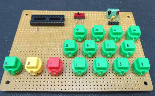

I have a 24 pin through-hole DIP package chip that can be used with a Maximite as a custom keyboard.
The chip lets you connect 12 buttons for keys, plus three for ALT, CONTROL, SHIFT modifiers. You would use simple buttons for all of the keys. The keychip can be used in conjunction with a PS/2 keyboard on the Maximite. The chip needs +5V and ground, plus data/clock connection to the keyboard port.
Here is a pic of a board made up to use the chip:
(Don: You should recognize those buttons.)
Right now the 12 keys are F1-F12.
The switch lets you select an alternate set of keys. I was thinking:
Up, down, left, right, space, page up, page down, enter, end, home
Could be used for games?
Or would 0-9, enter, escape be better for a keypad (like a password keypad)?
Thoughts, anyone?

CircuitGizmos
Joined: 08/09/2011
Posts: 1427
Posted: 02:14pm 28 Nov 2012
It can be plugged directly into the keyboard connector signals (data/clock) and will run off of the 5V on that connector, too.
In different words four wires from the chip to the Maximite keyboard connector, 15 wires to buttons. The buttons act as F1-F12.
Pull a pin low on the chip and select another set of keys for the buttons (up, down, left, etc)
This works on any Maximite.
I'll consider the cable - I'll look around for a good candidate.

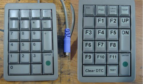

There are other possible alternatives.
Glenn Littleford (TBS admin) did one a while ago, but I couldn't find it in a hurry, however here is a thread I am following that lopezjm2001 has come up with:
http://priuschat.com/threads/my-duinomite-mega-canview-v4-eq uivalent-project.112429/page-17
These use standard PS2 short keypads.
Don...
EDIT:
Fount the other thread:
http://www.thebackshed.com/forum/forum_posts.asp?TID=4480&KW =keypad&PN=0&TPN=3
and a link to a possible contender:
http://www.ioffer.com/i/PS-2-Numeric-Keypad-Numpad-Number-Mi ni-Pad-Keyboard-NEW-189231744 Edited by donmck 2012-11-30

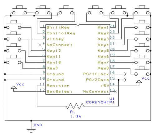

Posted: 10:54am 01 Dec 2012
The Maximite design uses a PS/2 connection as a keyboard interface. You can use a full keyboard connected to either a CGCOLORMAX1 or the CGMMSTICK1.

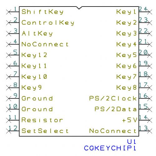

If you want to embed either of these two setups into a project, you might choose to replace the full keyboard with something either more compact or custom for your application. The CGKEYCHIP1 wired into a “ColorMax” or “stick” lets you create your own keyboard by adding your own buttons.
The CGKEYCHIP1 is a 24 pin chip in a DIP (through-hole) package. Four wires connect to the Maximite that include ground, power, and the two PS/2 communication signals (data/clock). You can wire in twelve distinct buttons for the keyboard keys plus three “modifier” buttons.
The CGKEYCHIP1 has two sets of keys that it can transmit:
Set1 - Set2
F1 - Up Arrow
F2 - Down Arrow
F3 - Left Arrow
F4 - Right Arrow
F5 - Space Bar
F6 - Page Up
F7 - Page Down
F8 - Enter
F9 - End
F10 - Home
F11 - Tab
F12 - Backspace
An input pin on the chip selects between these sets of keys.
The CGKEYCHIP1 runs off of the 5V that the PS/2 connection provides. Both chip grounds should be connected to ground. The pins marked “NoConnect” should not be connected to anything.
Supplied with the CGKEYCHIP1 is a 1.3 kohm resistor that has to be connected from pin 11 to pin 15 for the chip to operate correctly
The PS/2 data signals are open-collector signals. When you connect the GCKEYCHIP1 to a CGCOLORMAX1 there are pull up resistors already on the ColorMax. When you connect to a CGMMSTICK1 and CGVGAKBD1 combination, the CGVGAKBD1 board already has pull up resistors in place for the two PS/2 lines. No additional resistors are needed in this case.
When you connect the CGKEYCHIP1 to just a CGMMSTICK1, you will need to attach two pull-up resistors in order to have the chip function correctly. Each of the two PS/2 lines should be pulled to 5V through a 10 kohm resistor.
The SetSelect input to the CGKEYCHIP1 selects the key set that you wish to use, either set 1 or set 2. Connecting this input directly to 5V will select set 1, while connecting this input to ground selects set 2.
The key inputs are activated by momentary contact to ground. Simple buttons can be used.
