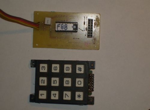

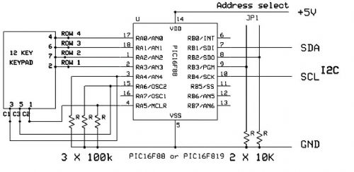

Here is a 12 key ascii output i2c keypad. It is an easy way to get manual entry data into an i2c based system.
Hex data files for f88 and f819 are in the zip file. Also a roughish PCB layout. I only use expresspcb and can provide layouts in that format if need be. As I have said with the other i2c modules, my aim is at the hobby constructor who can do up a vero board module. Driving instructions are also in the zip.

I have a keypad here i had spoken to David about, to adjust his firmware to suit, its a 16 key, stick on keypad, from China under $2.00
http://www.ebay.com.au/itm/3M-4x4-16-Key-Matrix-Membrane-Swi tch-Keypad-Keyboard-Slim-f-Arduino-AVR-PIC-ARM-/160776146959 ?pt=AU_B_I_Electrical_Test_Equipment&hash=item256f01500f
This will help make this chip far cheaper to making a I2C keypad.
Its a lot easier to cut a slot for the cable to exit, than a rectangle for the moulded keypad to fit into, not to mention the more professional look it gives, and with a peal and stick attachment.
If you said $1.00 for the pic chip, $1.00 for cost of making a PCB, $2.00 for a 16 key keypad, that's a easy lot of keys for $0.25 a key, on a 2 wire bus.
