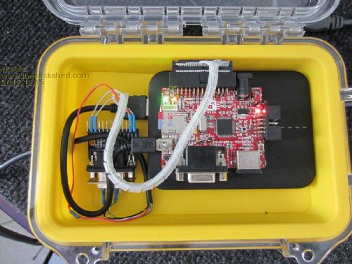

Hello
I have now completed the enclosure work for my 5 Hz GPS logger
It contains
1. Outboard GARMIN GPS 5 Hz
2. RS232 to TTL converter
3. DuinoMite Mini running MMBasic
4. 16 GB Class 10 MicroSD Card
5. Belkin USB 5 V back pack 2000 mAH
6. Saves to file very minute
7. Cuts daily files.
- Andrew -

Andrew,
Good work.
Can you tell me what Garmin GPS you are using and what did you have to do to get it to give you 5Hz output?
Are going to post the complete schematic?

Pretty easy
01. GARMIN GPS18 5 Hz - be carefull its 5 volts !
02. A little RS232 to TTL converter off ebay
03. The GPS gets 5 volts from the IDC connector.
04. The GPS TTL is connected to COM1 on the IDC connector
05. The GPS is 19200 N 8 1
06. I have connected TX RX VCC and GND on the GPS
07. On startup I can send the GPS $PGRMO commands to set the NMEA data
08. Once a minute the daily file is closed and re-opened.
09. 16 GB Class 10 MicroSD card
Please look on the IDC pin layouts I have posted before.
Running MMBasic 4.03B
Here is some code for you

Whats cool is it also feeds into my LINUX box
MySQL is used to populate a table of positions.
AVG is called to make and average position
I have a boat trip coming up soon
I shall field test the unit
- Andrew -

Been running for 6 days straight now - no issues
