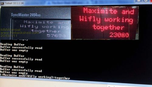

I got the Wifly module talking ok. Connect through telnet from pc. Send data over wifly, and read the serial buffer on com1:
Change any text that needs to be changed, and output to 21 dmd panels. For my test I have only 9 panels connected. Thats the easy part, as I just mirror the vga screen to the panels. Makes writing text easy...
I Use the spiDMD() command I added to the mmbasic source code. Thanks Geoff..

Here is a picture of telnet window with two pictures in picture. One of the MM vga output, the other is output on 9 panels (3x3)...final would be 21 panels 3 wide by 7 high

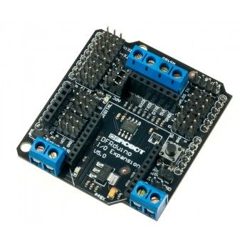

You can plug it into this shield.
The RN-XV is pin compatible with the XBee modules so any shield that supports XBee should support the RN-XV.
These are available everywhere including DFROBOT.com and EBAY.
