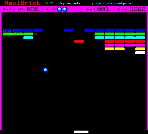

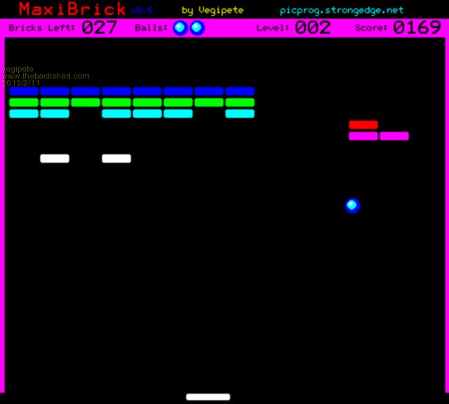

I've been busy writing a little ditty and here are some preliminary results.
Put the various files all in the same directory, then run *.BAS
Enjoy, and criticisms are welcome.
Source code commenting is a bit lackadaisical and I have been evil and used numerous hard coded constants but hey, what of it?
The game uses an analogue input on pin 1 to control the paddle position.
So sound yet...
/vp

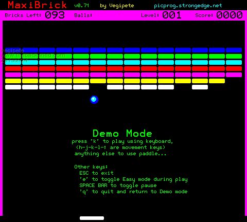

I've worked some more on this game. Now there is sound, demo mode and I added keyboard support per Nick's suggestion. But boy do I find keyboard control difficult! If anyone has suggestions for better keyboard control, I'd love to hear it.
As you can see, the demo screen includes basic instructions.
As before, the paddle is controlled by a pot on pin 1. However, the pin is defined in a statement near the beginning of the program and can be easily changed to something else.
I have also programmed CTRL-SHIFT-F12 to grab the current screen and save it to the SD card. The current time is used for part of the file name so over-writing existing files is a not too likely.
So without further ado, here is version 0.71
Enjoy!
/vp

Posted: 06:53pm 23 Feb 2013
Very good!
It looks good (good choice of colour) and the ball movement is excellent.
I like the way you have the instructions text at the demo showing off the Sprite capability of MMBasic.
You're right, the keyboard control is it's downfall but the same can be said about many games, my Donut Dilemma included. Keyboard is not a game playing device.
Unfortunately, you have to include it so that everyone can experience the game.
It may entice people to make a joystick interface (Atari interface also has X/Y paddle inputs)
Have you interfaced your paddle to the "standard" pin connections as defined by Darthmite?
The keyboard may be easier if using the left/right arrow keys. Also, is the H key a faster version of the J key?
It's good to see some great software that utilizes the power of MMBASIC coming out.

  Nick said  Have you interfaced your paddle to the "standard" pin connections as defined by Darthmite?
Yes, H is double the speed of J. I deliberately chose that row of five keys because it centers on K which you press to select keyboard control. My theory was that you could sort of roll your entire hand around the tip of your middle finger to move the bat back and forth. Of course there is theory and there is reality...
What was the "standard" pins connections that Darthmite chose? I didn't notice a conclusion. It occurred to me that the joystick discussion a while back got distracted with particular mechanisms as opposed to selecting a "standard" interface. (Nothing wrong with your choice of an Atari joystick, just not easily available...)
All good fun and entertainment!

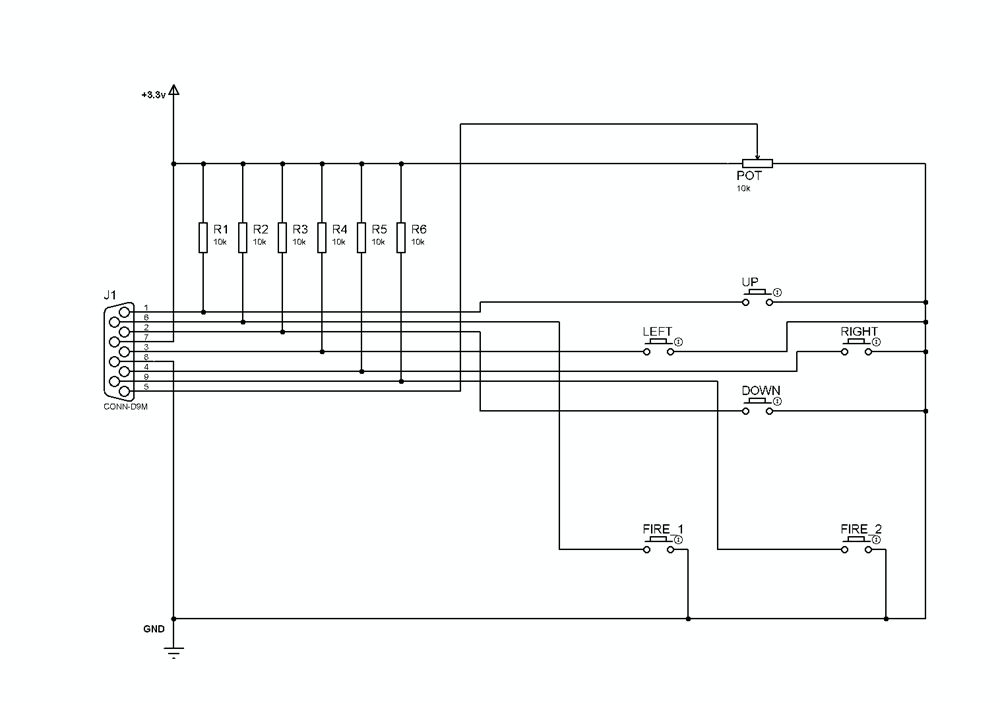

Here is the joystick scematic...
It doesn't list the Maximite pins but I know the buttons I use for Donut Dilemma were:
11 = UP
12 = DOWN
13 = LEFT
14 = RIGHT
15 = FIRE (Button 1)
Has anyone got definitions for Button 2, X-POT and Y-POT?
Darthmite? What's best here?
Nick
