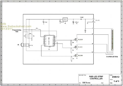

Hi Mick
you could use a picaxe with an IR sensor, this is a very simple circuit
and the programming is very similar to mmbasic.
you only need a tv remote to operate it.
only one channel would be required and if the MOSFET was mounted on
a heatsink, you could control the light directly.
also the oultput can use PWM control if you require dimming.

Hi Bill,
Thanks for the suggestion of the Pic Axe... I think I will go with John's suggestion above.
I have (I think) worked out how to use it..
I think I set it to receive mode and set latching outputs and read the IO pins to see what 8 bit code is being transmitted via my remote. Then I set it for transmit and link the IO the appropriate code and set for pulse and it will transmit it... I have everything I need except a Pic chip.. My pickit3 has a few adapter boards with ZIF sockets so I think I can program them ok... and I checked a Pic16F628/7 is only a couple of dollars on eBay. I only need to work out a delay cct for it to wait before it transmits.. Or change the code in PBP to do it there (prob best)
