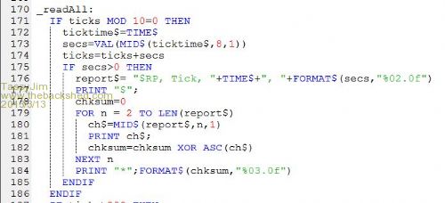

The latest update to MM Edit has a 'Format' command.
Indenting 400 lines of code adds 1k to the file size so there is also a command to remove the indenting.
You can set the indent level between 2 and 8 spaces.
I like 4 but 2 is a better choice for the limited screen space on the Maximite.
The formatting does NOT work on code with line numbers - sorry about that.
I am sure that there will be some layout that I have missed!
Formatting is a very useful way of checking that your loops are properly terminated.

The Format is working, but when I select "Remove comments and blank lines" or "Remove Indents and Trailing spaces" from the "Program" menu it deletes all the code. Undo restores the code. Anyone else notice this behaviour?
Greg
Posts: 6636
Posted: 12:52pm 13 Mar 2013
I have found the problem.
I had made changes to the way that line endings are done.
The problems you observed are due to the program getting stuck in a mode that I had not expected.
You can prove it by changing the line ending to dos or unix.
The fixed program has been uploaded to my website or you can extract MMedit.tkn from the attached zip and replace the one in the program folder.

I am ashamed to admit that there was another st...up in the latest release.
Removing indents was also removing comments.
This new version should have most of the bugs squashed.
The full version on the website has been updated or the tkn file is here:

Posted: 11:23pm 13 Mar 2013
It is getting better and better!
The formatting is super handy, making those indentations very visible.
Maybe working together with user Shoebuckle you can integrate his 'crunch' program.
I would offer a few 'paypal' beers for outlining. :)
Outlining is placing a small "+" sign before statements that have "blocks" of code.
Like FUNCTION, Sub, FOR, IF, ELSE, DO etc.
Larger programs can then collapse such areas to get a better overview.
Some other observations:
I would use a Pilcrow for the end of line indications. The ones used now are visually very dominant.
Also the whitespace markers are very dominant. Maybe use a very light grey?
If it is possible i would not show whitespace markers within strings and comments.
Adding spaces to code that is not within a subroutine gives at least for me the wrong impression.

  TZAdvantage said   It is getting better and better!
Outlining will have to wait until I have sorted out the bugs in the latest 'features'
I am relying on Scintilla for the fancy stuff and I am not sure if I can ever do outlining.
I can change the white space markers so that they do not appear in the indent areas. I think that will help a lot. That is the only choice. I might be able to change the shading a bit for you.
The end of line markers are a Scintilla thing and I don't think I can change them.
There is an option in preferences to indent labels. Remove that option and you will have the layout you are after. At this stage, the change takes place after a restart but I will change that to act immediately.
