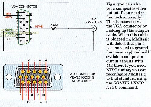

paceman
Joined: 07/10/2011
Posts: 1329
Posted: 09:23pm 26 Mar 2013
Arvindk,
From Mick's PDF Manual (last page) for the UBW32-CMM:
There is a track missing on the UBW32-MCC PCB, associated with the auto-detect for Composite Video....the fix is easy though....if you wish to use pin 9 as a composite/VGA select pin on the UBW32-MCC PCB you will need to run a jumper from VGA pin 9 to UBW-C14 (about a 25mm or 1" link).
Also from Geoff's CMM article in Silicon Chip magazine Oct 2012:
As noted in the image, you'll need to make up a VGA to Composite (i.e. video) adapter cable to plug into the UBW32-CMM VGA port and then the composite video end to your composite screen.
Edited by paceman 2013-03-28

Joined: 31/10/2011
Posts: 21
Posted: 01:18am 27 Mar 2013
Thanks Paceman, but I thought that composite connection can only be monochrome, and the 5" screen talked about are probably colour. Is that correct ?
I did read the pages you refer to and have no trouble making up an adaptor, but lack of colour bothered me somewhat.
The DX.com product discussed by Greg did not appeal because it shows a PCB lying next to the screen and I am not sure where it goes. I just do not want to have to do a lot of work, just something I can hook up and start using.

paceman
Joined: 07/10/2011
Posts: 1329
Posted: 02:39am 27 Mar 2013
Arvindk,
Yes, the composite output can only be monochrome and it goes to a composite video input, i.e. TV-type screen. It doesn't matter that the video screen can display colour (like a TV) because all you'll see from the UBW32 CMM is mono, as it is for all the colour Maximites.
The 5" screen mentioned by Bill.b above is a colour composite input screen usually used to connect to reversing video cameras on cars or security systems. Composite video inputs have just the one central active input pin, usually a yellow RCA connector and that one pin can supply colour if the signal to it has the colour information - that's not the case with the CMM's composite output.
The 5" VGA monitor mentioned above by Greg Fordyce is VGA , which can be driven with colour from the VGA connector of all the colour Maximites. There are several pins involved in this via a standard computer-type VGA cable. VGA screens generally look better but are typically about 3X the price of video screens. That's why 'djuqa' above said they're preferable to use as standalone screens for Maximite projects - unless of course you do really want a colour display in which case you have to use a VGA screen.
