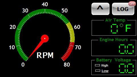

Sure... I currently have the µLCD-144-G2 (good for simple interface) (no touch)...

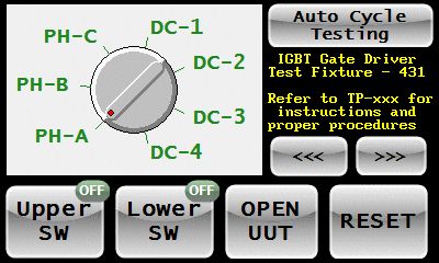

also have the µLCD-32WPTU (with touch) and am designing a test fixture at work for testing IGBT driver PCB's (see pix)... Also have the µLCD-43 (P/PT/PCT) unit and using it to design an "engine information system" for ultra-light aircraft. (nice)
Anyway, the thing is, they all use a simple serial com interface. You can write your own code that runs inside the GPU, or go code-less, as I did !.. Just layout your active objects and compile... It uses a simple com protocall to let the Maximite know what the user is doing..! (sweet)
Check it out...!
