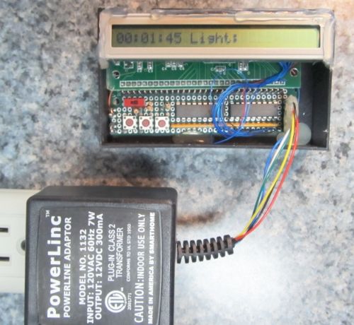

Here is something I made a while back. This is a light controller made using Maximite technology. This is definitely a one-time project kludged together until it works and then forgotten. This has been running for months. Here is a picture:
I'm presenting it here to show that the Maximite can be the brains of a project that just sits there all day working. Doing its job.
The kludge in the picture:
PowerLinc serial x10 interface. They don't make these anymore. It provides 12V for the project.
1 1x24 LCD
A bit of protoboard with three buttons and a switch.
An ALMOST-CGMMSTICK. This one was a prototype. May as well use it.
Interface chips to go from 3V to 5V for the LCD.
I wrote code to get it to work, but no refinement for elegance.

The code goes onto drive A: (internal) as autorun.bas
I change the on/off times during the year as I see fit.
The switch is for set time in one position and run in the other. Buttons are for setting time.
X10 adapter accepts odd serial commands. They are repeated to make sure the signalling happens.
Not posting a schematic or any detailed info - this is more or less not a reproducible kludge. But I'm open to answering questions if that helps anyone's projects.
