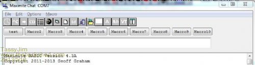

The search function has improved and there is a macro feature in the Chat program
Now that MM Basic has the implied run and command line reading, macro can be used to advantage.

Single line macros added to Chat window (Hold shift key to edit macro)
Multi line and control codes for macros to be added soon.
