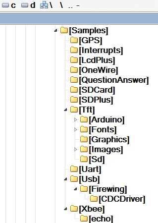

Dietmar, just look for some samples for PIC24 - look inside
c:\ProgramData\Mecanique\Firewing\Samples\ if you have Win7 or bigger.
You should just change the device, adapt the sample to your pins (start with a LED blink) and you should be able to compile. Everything I know now are by browsing the Wiki, the forum, and Firewing folders.
As a last resort, forums are always open (this thing will increase in popularity).Edited by vasi 2014-03-16

I get also errors when I set the compiler to Firewing32 and Chipkit MAX32...
For CHipkit UNO is compiling just fine. Then, I looked inside
c:\ProgramData\Mecanique\Firewing\Includes\
You will see that there are no files for the desired microcontroller.
A solution may be here, but I won't pursue it further as I have some problems with my Windows - I will let this for another time (I also have a cold which makes me a little tired).

Solved!
After including the PIC32MX795F512L device .BAS file (generated with sysgen32.exe) in the Include folder, I get the same error as you. Changing the compiler from Firewing32 to Microchip32, the program compiles just fine. The only "error" is that the code size is not displayed correctly but this is an old bug, not sure if it happens only on my PC.
