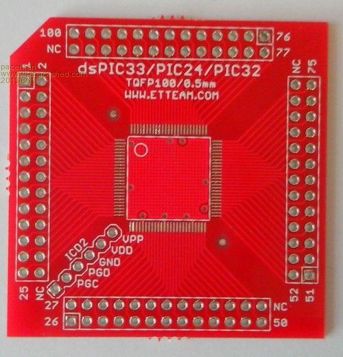

Well I finally got brave and used one of my virgin $10, 100 pin, 0.5mm chips (PIC32MX795F512L-801PT) from MicroChip to ‘grow’ a Colour Maximite (CMM) on a break-out-board (BOB) I bought. This BOB can be used to make a CMM or alternately it can be used as a ‘generic’ PIC32 giving access to all pins. I wanted to be able to use it in both those modes so that I could use it in CMM projects and also use it for loading some stand-alone learner hex files compiled from C code via my PICkit 3.
I’ve bought Lucio de Jasio’s book that Geoff recommends (Programming 32-bit Microcontrollers in C – Exploring the PIC32). The book’s basically a start-from-scratch lesson in C for the PIC32 using the MicroChip’s free MPLAB IDE and C compiler. A lot of the example code assumes though that there is access to any of the PIC32 pins, i.e. a ‘generic’ PIC32 which is not the case if the chip is hardwired as a CMM. To be able to swap between the two ‘modes’ I’ve made it so that any ‘non-generic’ connections required to use it as a CMM are done on a separate proto board e.g. the I/O connections for USB and VGA, or, in a couple of cases as mods with linkable pins added to the BOB.

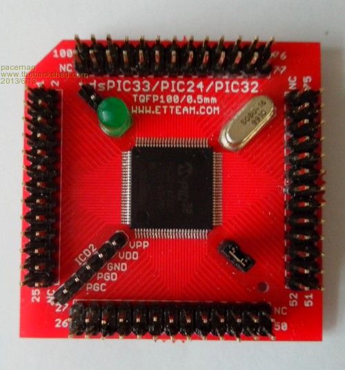

The Break-out Board and Mods.

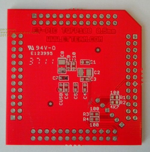

This BOB is made by ETTEAM (www.ETTEAM.com) in Thailand, as is Mobi’s board, and available for about $2 from several places, e.g.Break-out board It’s a bit different from the board Mobi sourced from Futurlec in that it has connections and pads for the support components in SMD format underneath, which I think is pretty handy, and there’s also an ICSP header provided to program it. Here’s how it looks on arrival.
As you can see it has the values for the resistors marked, but not for the capacitors – very helpful, and I couldn’t find any documentation on the ETTEAM site. I Googled around a bit and found this blog PIC32 BOB which also has a link to a schematic giving all the capacitor and resistor values – they’re probably standard off the chip documentation but I wasn’t keen to read through that – yet! From what I can make out it’s pretty much as Geoff has used for the CMM but there are a couple of ‘gotcha’s’ in the connections – more on that below. The infamous 10uF capacitor on the Vcap line is shown as a ‘normal’ tantalum and for that I used a 1206 format 6.3v Jaycar cap I had on hand (P/N RZ6541) which so far has worked fine, although I am a little nervous about the 6.3v limit. I now have some of the low ESR ceramic caps Geoff recommended so if there’s a problem that’ll be the first thing I change!

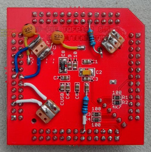

Here’s how the BOB looked after I soldered in the PIC, the support SMD’s, the header pins and my mods.
Soldering the PIC wasn’t as bad as I thought it would be. Geoff has directions on his website for this and so do several others on YouTube so I won’t repeat it. The SMD resistors and caps I’d previously sourced from Rockby for pretty reasonable prices (around $3 to $5 in 100 or 10 quantities for resistors and caps respectively) but you can also get them in multi value packs from eBay for $10 or so, e.g. SMD packs
When you’re doing the soldering you definitely need a lighted magnifying system of some sort. I have a small stereo microscope that works well but I think one of the large-ish diameter magnifiers with in-built LED’s would be a good option too and a lot cheaper.
No doubt you’ve noticed some ‘extras’ on the BOB. These components/connections were added using through-hole components. I drilled through the BOB along the diagonals (where there weren’t any top tracks) using a little “pencil’ hand drill and a small piece of proto board as a 0.1” spacing guide. The drill diameter was selected to give a close fit for header pins. On the bottom the drilling goes through the copper of the Vss (Gnd) plane grid so clearance was made by trimming around the holes with a sharp Stanley knife – a bit finicky! I super-glued small pieces of proto board under the BOB in line with the holes to make the connections and to give a solid base to the header pins inserted from the top – thinner proto board than the 1.6mm I had would have been handy here. These headers then allow for links needed to maintain the ‘generic’ mode in a couple of circumstances, as below.
The mods made were:
1. Adding the 8MHz crystal and caps – a permanent mod. The Vss (Gnd) connection of the two 22pF caps was made directly to the Vss plane at the back of the BOB by scraping away a small area of solder mask.
2. Adding a linkable connection between Vusb (pin 55) and Vdd (3.3v) at pin 62*. This link needs to be in when used as a CMM and for probably most other situations, but it will need removing in some ‘generic’ cases.
3. Adding the 10 ohm resistor between AVdd (pin 30) and Vdd (3.3v) at pin 37*. Currently I’ve hardwired this as a permanent mod but it shouldn’t be for ‘generic’ use. I figured I was unlikely to want to use an external voltage reference for a while at least - but then you never know… This mod was a bit tricky because AVdd needed to be picked up at the PIC32 end of C4. Luckily there’s a via going to C4 at that point which made poking a very short resistor lead into it possible - but I did need to scrape away a tiny area of solder mask to get a good connection.
4. Adding an LED with current limiting resistor (330 ohm) that can be jumpered to any pin and the ‘other’ end to Vdd or Vss. I’ve currently got the LED hardwired as per the CMM, pin 93 and 3.3v, but to keep the ‘generic’ capability the LED needs to be controllable by other pins and in both current source or sink mode i.e. the ‘other’ end connected to 3.3v or Gnd.
*Note: The connections to Vdd (3.3v) noted in points 2 and 3 don’t have to be made to those particular Vdd pins, any Vdd pin will work, they were just closest. It would probably be better to connect them to the Vdd power plane but unfortunately that’s not possible because it’s inaccessible under the PIC32 chip.

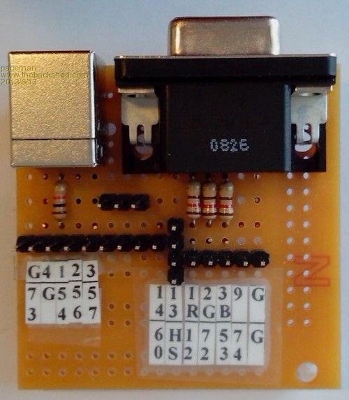

The I/O Board – USB & VGA (so far).

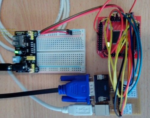

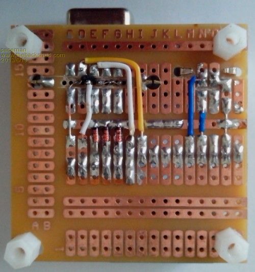

The next adventure was trying to make a neat-ish I/O board for the CMM USB and VGA connections broken out with pins to jumper to the PIC board. I was trying to keep it reasonably compact so that I could later put an SD card reader behind the other connectors – yet to do. Here’s what I ended up with.

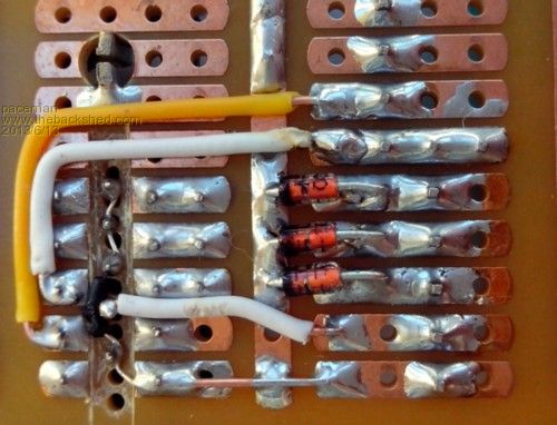

I’ve included a magnified photo to show how I soldered the VGA pin diodes and the series of Gnd connections on the VGA connector. These ground connections were finicky. First I had to drill holes between five of the normal proto board holes to accommodate the offset second row of the VGA pins i.e. pins 6 to 10. Then pins 5,6,7,8,&10 needed to be connected to Gnd but pin 9 (the composite select pin) had to be kept insulated. To do this I cut a V section out of the proto board along the offset middle VGA row. This electrically separated all three rows of the connector and then I looped some bare wire-wrap wire (it had to be fine) along the ground pins at the base of the ‘V’. I threaded a very small length of insulation (off some hookup wire) along this wire to pin 9 to maintain its insulation before I soldered the fine wire to the Gnd pins.
I hope that all made sense – in the end it might have been easier to do what Mobi did and etch up a proper board - except that I’ve yet to get into etching boards.
I mulled over how to connect the four pins 77, 69, 47 & 14 for the CMM VGA horizontal sync, but still be able to use the BOB in ‘generic’ mode with them un-connected. In the end I settled on connecting them at the I/O board. I wasn’t confident this would work but amazingly it did. Those pins can be seen aligned vertically to the other jumper pins in the ‘top’ photo above.

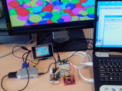

Running USB and VGA and composite.

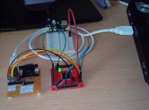

The photos below show firstly the setup for VGA and USB together (jumpering getting a bit busy) and then the whole thing running Geoff’s demo COLOUR-1 program. I fed the VGA output of the BOB to a $12 VGA to Video converter and then the converter’s VGA and composite outputs concurrently to a Dell VGA screen and a small $25 composite screen.
All this shows, as Mobi has also done, that you can have a full 100 pin ‘generic’ PIC32 on a break-out board for ‘training’ and still be able to convert that to and from a Colour Maximite configuration. Now for the SD card, the clock and a 3.3v supply – I reckon they might fit on the I/O board with a bit of juggling.

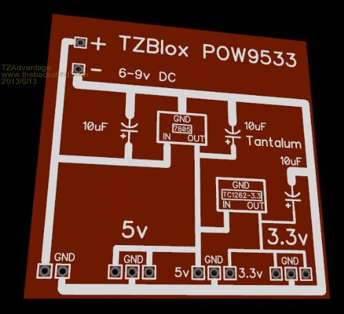

As you maybe know i am busy designing 'blocks'. The PIC32 MCU 'block' will be smaller then the one from ETTeam but the idea is the same.
My biggest decision i now have to make is which connectors should i use.
The idea is to have square 'blocks' that contain the circuitry and have connectors on the top side. When connecting these 'blocks' my first idea was to use female headers so that you can use male-male cables to connect them and also use the same male-male cables to connect to a breadboard.
I see that you used the male headers and use female-female cables.
Was that for a particular reason, or was it what you had available?
Using what you have is always good. In my case i will need to order and would like your opinion which would be better.
I think that the male header pins are all open and therefore for less careful people or ones that are starting there is a danger of shorting them inadvertently.
I need to make my 'blocks' as fool-proof as possible and thought the female headers would help with that. However if availability or usability is better with male headers i can weigh that in my decision.
For the female headers there are two types, the normal ones from the same series as your male ones, or the sip line.
I am finalizing my design and would appreciate some feedback on this 'dilemma'. I will need to make a decision about those connectors pretty soon.
Below is an example of the power 'Block' to get an idea how they will look like. Others like port expanders, digital potentiometers, 7-segment, wifi are also almost done, a few more like EEPROM/RAM/FRAM, servo control, keyboard, bluetooth, RTC, RFID, Joystick, steppermotor, battery pack etc are on the drawing table. It will all be open hard/software and contributions and ideas are very welcome. Most of the communication will be with I2C.
This is the topside of a PCB, components will be on the bottom side to protect them from damage. These PCBs will then function as a 'lid' for a small box made from plastic or aluminum for a deluxe more sturdy version.
The special idea behind it is that once you have made a working project out of those 'blocks' you would then be able to order a pcb with all the circuitry on it, wired exactly as it is done on the prototype and have a end product that is worthy enough to be showed and sold and freeing up the 'blocks' for the next project.
