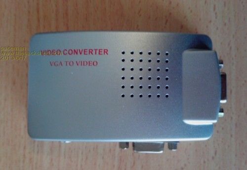

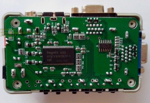

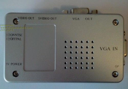

Frank, I've got a small $25 composite car colour back-up screen running on the Colour Maximite (actually the CGCMM). It uses a small $12 VGA-comp converter like this:
You'd think the connectors would all have to be worth more than $12 let alone the electronics. If some clever person could figure how to get just the two main chips on a little BOB to sit on/in the CMM then the cheap composite back-up screens could be used for embedded projects.
The two big chips are a special 128 pin converter "VXiS VX1937 1217-22145440" and a 50 pin 1Mbit ram "Hynix 605B HY57V161610ETP-7". It uses mini USB and has an AMS 1117 3.3v p/s, a 74HC04 D chip and a 27MHz xtal.

Paceman,
Yeah I have the same one. The color correction and offsets have to be keyed in manually EVERY time the interlacer is powered up though; which precludes using it in and end product.
Unless you found an elegant way to use it?
Frank
paceman
Joined: 07/10/2011
Posts: 1329
Posted: 05:12am 17 Jun 2013
No, I'm afraid not and for one-off jobs like most of us do you may as well get a $70 slightly bigger VGA. Actually I think Mick found a 5" (?) VGA recently for around $55.
