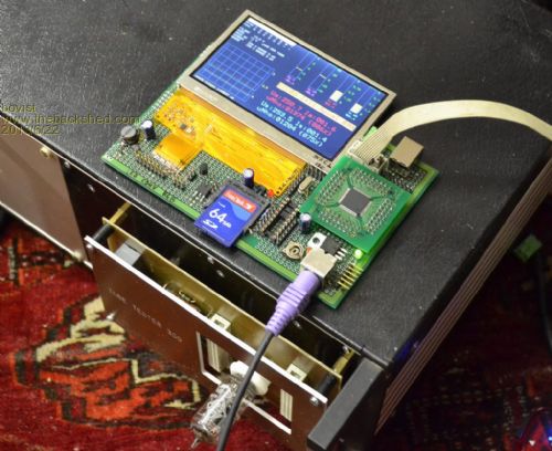

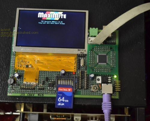

Hello all,
I just got the MMBASIC sources from Geoff (thx for this great project!). Due to his great documentation I was able to tweak it a little, making it work with a cheap Sharp LQ043 TFT (Playstation Portable spare part, available on ebay for around 19 US-$), without any additional hardware (no TFT driver chips etc., just a LED illumination step-up converter LT1932 needed)
Conversion was pretty easy since the SPI outputs the desired clock signal. Connection:
SPI Clock (any SPI channel) to Display Clk
HSYNC to Display HSYNC
VSYNC to Display VSYNC
RED to Display R0..R7, wired together
GREEN to Display G0..G7
BLUE to Display B0..B7
POWER LED port pin by PNP transistor (BC557 as inverter) to Display DISP_ON
Display LEDs need about 20mA @ 22V. Display logic is specified @2.5V, but also works with 3.3V (few mA). Analog Voltage is 5V from LDO regulator input.
I just had to discard the SPI/DMA 4 byte padding to get the display properly aligned. Also a RC delay (5k variable resistor with 47p to Gnd) has to be inserted between HSYNC out and the 3 framing SS inputs. The display is crsip with a resolution of 480 x 272 pixels which yields 22 lines of text. Since the resolution matches the Maximite's, there are no distorted characters.
On the picture attached you see my homegrown Color Maximite (i.e. just the PIC32, PS/2 connector, I2C to my hardware and USB, no other ports yet). Second picture shows a tube testing BASIC prog attached to my tube tester hardware.
If anyone is interested, I can post the mods to video.c (with permission on Geoff) and my schematics. This should also work with other TFTs, although horizontal resolution of 480 is best. The only drawback: You can't use Mode 4 acceptably since it has a different timing (screen is just smaller, rest is blank).

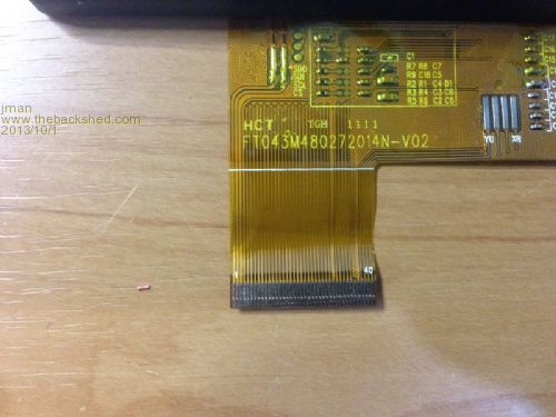

Would it be possible to post the complied hex file and a circuit diagram
This looks like the screen Ebay
That LCD connector looks rather small .5mm I think.
In an effort to make it easier for my old eyes I will be using one of these for my build. Breakout PCB

Mick, these PSP 3000 types do not work since they have a totally different serial interface proprietary to Sony. I just found a datasheet - avoid them! Otherwise, any display up to 480px wide with digital 3x6 or 3x8 bit parallel interface (i.e. many pins) should work, maybe also some monochrome units. There are some older STN types out there with analog color inputs which also don't work with my scheme.
The PSP 1000 display seems to be an off-the-shelf type which is widely available by several manufacturers; I would go for this one on my PCB. I will speak to my distributor if he could make a pre-assembled kit with display connectors and PIC32 mounted. There should be also an alternative to the LT1932. LT makes great components, but they are rather pricey.
Also, I would like to invite Geoff to become an author for an article in our magazine - he won't get rich, but it's some nice pocket money. Unfortunately, I did get no response yet - maybe he's on vacation right now.
For those familiar with MPLAB C compiler here are my changes to Geoffs code in "video.c" source file:
// Parameters for PSP Display by C. Meyer
// Graphics is 480x272 pixels. This gives us 80 chars per line and 22 lines per screen
#define VGA_VRES 272 // 272 Vert graphics resolution (pixels)
#define VGA_HRES 480 // 480 Horiz graphics resolution (pixels)
