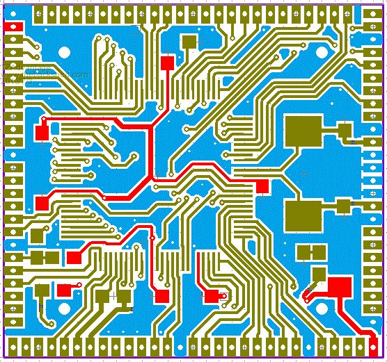

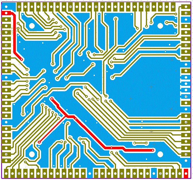

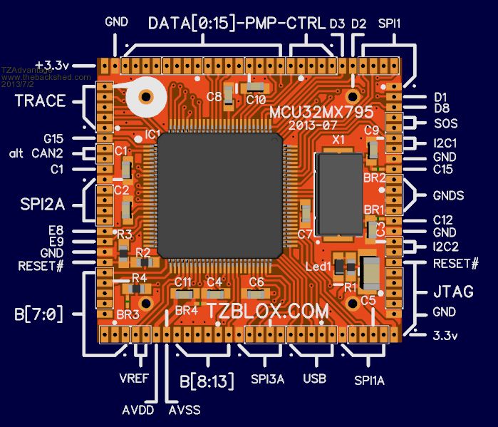

These three are scheduled first, only the CMM module needs to have a onboard power supply so that it can function stand alone.
TZBlox POW9533 TZBlox POW9533 - A power supply input 6-9v DC output 5v, 3.3v both 500ma
TZBlox MCU32MX795A TZBlox MCU32MX795A - A MCU module based on the 32MX795F512L from Microchip
TZBlox CMM TZBlox CMM - A enclosure containing the MCU32MX795A module and all necessary connectors

All blox will have an enclosure and male connectors for easy use while prototyping.
The link of the TZBlox POW9533 shows a rendering of the top plate. It has the schematics printed so that it makes it easy to see what each pin is connected to.
Obviously for complicated schematics this will be simplified as a block diagram.

The CMM Blox is a MCU32MX795A plus a carrier that has all the connectors. for a mono MM it can be a different carrier. It might be easier to just use a MCU32MC795A and connect only what you need. It would still function as a CMM if you load the right software.

I got some feedback since i posted and after careful study of that feedback and the datasheet (again, but very focused on layout decision) the MCU32MX795A has gone through some major changes.
I thought i was very close to a final design. One thing was clear, the module has components on it not suited for a generic mcu board.
So i first dropped the "A" from the model number, the "A" stood for Additions.
The feedback gave some real world examples that would not be possible and that was a great concern because i especially want this module to be very generic.
More generic then for instance a UBW32 or other similar products. Those are always using pins for certain switches, leds, USB wired as a client, etc and are not free anymore for use. This can disqualify a module for use.
Also the supervisory chip, 3.3v regulator, rtc crystal are all taken of the board as in most if not all cases these are better placed elsewhere.
The more simpler, the more robust and easier to use is the new motto.
For systems on a module there are other solutions currently available and that is not a part of the market i aim for. I need to remind myself of that. KISS!
Components are now placed on one side, allowing it to be used much easier, even soldered directly to a board.
This required a whole redesign of the board as great care has to be taken with placement of the decoupling capacitors and crystal. Official recommendations of Microchip are now strictly followed. Ground guard tracks, no crossing signal under the crystal, that sort of stuff. Although the PIC's are very forgiving and work almost all the time it never hurts to be as good as possible.
I was able to keep it a two layer board that will keep costs down. I want this module to be your preferred choice instead of buying a bare chip.
It will be easier to handle and takes care of the essential parts.
There are now 3 optional subparts that can be left out for very specific solutions.
Second and third are more an "opt-in".
Those subparts are normally included because most are in almost every design.
First, when you want to use the internal oscillator you can choose to leave out the crystal together with 2 capacitors. Bridging two small copper islands will connect those PIC32 pins to the connector.
Second, the AVDD and AVSS are brought out straight for providing your own analog voltage and ground or with small solder bridges can use the on board resistor and capacitor.
Third, there is a resistor and led for a power indicator that can be made part of the circuit by bridging, especially important if you want to run the module from a battery. Here is such a simple modification many modules currently in the market fail.
My own thoughts about laying out the PIC32 pins in a more convenient way has also been done. Pins that belong to a certain peripheral are now placed together with an added GND and some supporting GPIO. For instance the SPI peripherals are now grouped and have a fixed pin order.Having one or two gpio pins next to it that can be used as a select line will prevent long traces.
Makes it much more easy to design a carrier board because all the pins needed are right next to each other.
Organizing the SPI also has the added advantage that I2C,UART are organised as well because they share pins and internal peripheral. I2C has no on board pull up resistors because that will render them useless for other purposes.
It will also allow for future other MCU boards to be made that use those same connector locations. Maybe a PIC32MX4 serie is enough or a PIC18 depending on your needs. Or you want an ATMega? The new PIC32MZ?
Defining where all the serial ports are will make this possible.
Of course a connector can never be really generic, just keeping the serial pinouts and a few gpio, analog and PWM capable pins on specific locations will allow for flexible MCU choices. It is not really a big factor as most of those processor module connector definitions do not seem to live very long as capabilities can outgrow the designers imagination very quick.
The pins for JTAG and TRACE are also grouped for ease of use.
All the sixteen databus pins of the PMP are next together in order and PMP control lines too. This allows for easy connection to parallel devices such as LCD, TFT or DACs. They are all on one side so placing that 50 pin header for a TFT becomes a much easier task. Also memory chips like SRAM or FRAM are easy to lay traces for.
It all resulted in an even smaller board measuring 27.5x29.5 mm.
It uses a 1mm grid that is much easier to solder then the PIC32 which has a 0.4mm pitch. The small size will allow very small designs and a choice can be made to go 2 dimensional by laying out the module and parts on a board next to eachother or go 3 dimensional and stack them.
The 1mm grid allows for headers to be mounted to have a pluggable stackable MCU module.
[edit picture added]
It also has 4 small mounting holes that will be of great use when lining up the module for soldering. The mounting holes/pads are placed at 20mm distance and the holes have a 1mm diameter. These are pads connected to GND.
They can also be used to tighten the board together when used in a stacking arrangement. Great when you use the boards in rough and shaking environments like robots, small helicopters or even your car, you can now go off-road. :)
Small things like adding a big white dot to the silkscreen to make clear where pin 1 is. And there is a small line next to each tenth pin and a small dot next to each fifth to make finding a particular pin easier.
I am just finishing the 3d model and when that is ready i will post the result.
Remember this module is not a 'Blox' but a part of it. A 'Blox' is the prototype friendly breadboard companion with very accessible pins, the module is what is inside and what goes on your final product. It will make sure you have exact the same components on your final product as is in your breadboard version. Something all other development boards do not!
Some new negotiations for the PCB manufacturer because those tolerances are tight.
At least for prototypes and pools.
If someone has suggestion about a manufacturer that can make prototypes that have 0.2mm traces and 0.15mm clearance i am all ears.

A quibble: you order some of the bits high:low (like B[7:0]) but others low:high (like B[8:13]) so maybe stick to one order.
Are the DATA[0:15] what Microchip call PMD0-PMD15?
Where are PMA0-15? (or PMD0-15, if the DATA ones are PMAxx)?
Is there something to stop it being accidentally oriented 180 degrees around?
BTW, to see the multiple functions of pins I refer to Olimex schematics as they show each function by each pin. Such as on PIC32-MAXI-WEB and Duinomite eMega.
