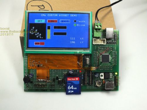

after I got a cheapo 4.3" TFT working perfectly on my DIY Color Maximite (see my other post), I wondered if MMBASIC could also handle a touchscreen. Well, it does -- just needs some additions in MM_Custom.c sources:
YouTube Video
Button and screen handling is completely done by my MMBASIC extension, written in PIC32 ANSI-C. My MMBASIC has commands like TouchButtonCreate(x,y),index,caption$,color etc.
For this demo, I needed only 40 lines of BASIC code. HEX file coming soon! Preliminary schematics can be found on my github repository.
Greetings,
Carsten Meyer
www.keyboardpartner.de

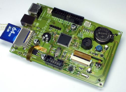

Just got the prototype PCBs for the TFT Maximite last friday and made it work. This is a 2-layer PCB. Shortly beeing proud of the instantly working prototype, but damn, I forgot the resistive touchscreen connector and had to wire it manually. And the touchscreen would need a buzzer for a touch feedback to the user. OK, next try...
Here is a better video of my new TFT Maximite prototype.
Anyway, the touchscreen is a totally new experience to MMBASIC use. You won't need a keyboard or separate buttons anymore. Rework of MMBASIC programs for touch use is pretty easy. On start of your program, you define the active touch items, for example:

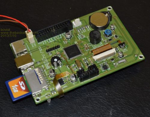

Just a quick question about your prototype. You have the Arduino Connector missing from the schematic but the pins from the PIC32 are assigned.
Also the PCB, you have some pins roughted for the Arduino Connector and others not, as well as no Arduino Connector.
Is this on purpose?
Just wondering as it would be good to also have the Arduino Connector option to play with.

Hi,
I ommitted the Arduino connector since 4 analog inputs plus one digital output are to be used for the touchscreen interface and the buzzer. Also, my new small PCB (only slightly larger than the display itself) simply has no space left...
