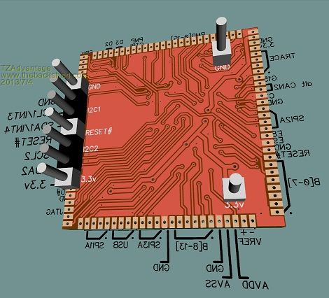

This is the 3d rendering of the top the size is 29.5mmx29.5mm!:
The most interesting change made from the previous version is the inclusion of pins on a 0.1" grid. This will allow quick connections, even on a breadboard. I show later in this post where this really shines.
The pins are all on one side and they will be the same on all Blox.
All these lines can be shared like a bus. There are two I2C busses, the idea is to use one as a slave and the other as a master so that communication between modules is extremely easy. A reset line for letting other blox know the system has been reset or a specialized Blox that can assert a reset under certain conditions. Watchdog anyone? :)
The bus also has power lines, in this module only GND and 3.3v are used but there are two more lines possible of which one will have 5v and the other can be made project specific.
The size of the module allows 11 pins on a 0.1" grid to be place on one side.
To see the pins more clearly here is a rendering of the bottom:

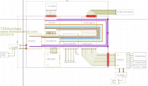

As an example how these Blox can be used i imagined a project that uses several of them. The imaginary project is a control system for aquaponics. It will need 3.3v regulated, a microcontroller, 8 analog inputs, 8 relays via optocouplers to electrically isolate them the controller, 16 io ports to read overflow switches, a display and a usb SD card.
I then sat done and used Blox to assemble the system. (Blox shown are still in development, it is a proof of concept.)
Within 30 minutes i made the 'schematics' consisting of blox and with measurements it can be made on a 10x15 centimeter carrier board.
As you can see on the next drawing the carrierboard just has a few bus lines and for the more demanding blocks interconnections.
Blox are design that the bus goes from left to right, interconnections are at the top and output at the bottom. As in the picture you can loop the bus around so that the interconnections face eachoter saving lots of traces.
Here is the link to a better resolution:
http://tzblox.com/Documents/_TZBlox_/MCU32MX795

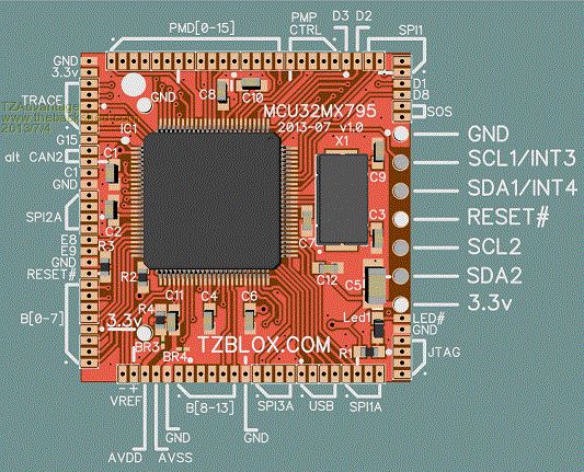

Is there a reason for the 100 mil offsets between the two pairs of GND and 3.3v lines? I can imagine space is an issue, but two extra "lanes" out of your 11 could be reserved for something else using stripboard.
For documentation purposes, keep the ranges (like PMD[0-15]) [low-high], and I see that you have used a diagonal dot notation for order. I'd guess this is the low end, so perhaps just add an annotation to Top.jpg?
Also I see you have X1 (8MHz) but I'm missing X2 (32768Hz) for RTC.

  Dylan said   Is there a reason for the 100 mil offsets between the two pairs of GND and 3.3v lines? I can imagine space is an issue, but two extra "lanes" out of your 11 could be reserved for something else using stripboard.
[/quote]
Space was an issue and i could not get it routed. After a good time sleep and a fresh look, and a good reminder from you, i have solved it and they are now in the same 'lane'.
[/quote]
You have guessed right. :) I should indeed make it more clear.
[quote]
[/quote]
I dropped the inclusion on the board because i never hear someone say something positive about the onboard RTC and it seems to not be used a lot. The pins are available for when you need it they are the ones marked with SOS.

I think the inclusion of the 0.1" pins and keeping them at 0.1" spacing with the other two on the board is a great idea - especially for ease of development.
One thing I'm wondering. I presume all the 0.1" pins are solderable because the renderings look like they're not. They would need to be to allow them to be mounted on a breadboard, and the size of the holes would need to accommodate whatever the standard pin size is for breadboarding.

All the pins on the 0.1" grid have standard header pin size holes.
So yes, you can plug it into a breadboard.
And what Dylan mentioned using a stripboard is great.
Just solder a few female headers on it and you can plug them right in.
I have changed the layout slightly by moving the left GND and 3.3v pins on the same 'lane' as the others on the right.
Also i use the top left 0.1" grid pin as the home location.
The 1mm grid pins start with the top left on -100,-250 mils.
This will make it easier to draw a footprint when you want to make your own carrier pcb.

Since you went from 900 mil to 1000, which is not a problem for I2C on a breadboard, perhaps the standard "host" should always have 2 pins 100 mil east from the power lines on the left.
1000 mil-wide modules would still be able to use both I2C channels, but potential future 900 mil-wide modules could use (11-2)x2 = 18 data channels of some description or another. Perhaps two fewer if 5V is reserved as a main bus (useful for servos).
