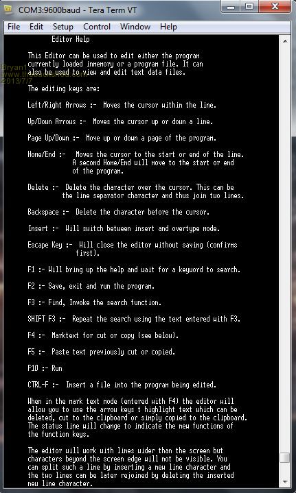

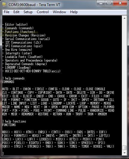

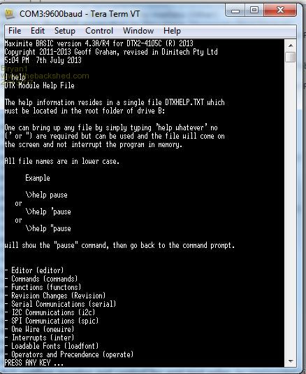

Hi Guy's,
Here's a few pic's of the Help system as viewed in TeraTerm
The Main Help Screen
The Commands and Functions (Still more to add)
The Editor Help Page (not noted as yet is the ability to create files)
Regards Bryan

Thanks Bryan,
in the next revision (probably) there will be active help as well. In the editor if you press F1 over a keyword, it will bring up the help page for it. The editor itself may need some revitalisation, but that is going to take more time to happen.
