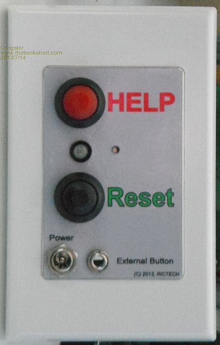

Posts: 10070
Posted: 03:34pm 13 Jul 2013
Here is a couple of photos of finished labels on products.
Both these labels were designed using Front Designer decal software, and produced using the method listed above.
These are two different products. The call-buttons system box does not use the wall-plate units, it was just the two photos I found first.
These photos do not really do the result justice - the photos are a bit grainy and washed out. The actual result looks better then these photos, but the shots will give you an idea anyway, of what the finished result looks like.Edited by Grogster 2013-07-15
