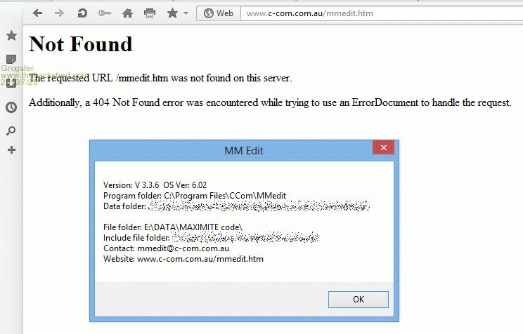

The link in MMEdit's ABOUT window does not work.
I tried www.c-com.com.au/mmedit.htm as in the window, but it is 404 not found.
404 also for www.c-com.au/mmedit.htm
Can you please repost your current site, and I will bookmark it!
I can't remember where I found MMEdit from before, but do you think I can remember it now???(rhetorical!)
I thought I had already bookmarked it, but......... Edited by Grogster 2013-07-26

ADDITIONAL: Nevermind - I see the link is in Jim's signature.
Obviously, it cares about mmedit vs MMedit...

Posts: 6624
Posted: 02:45pm 24 Jul 2013
You are correct, case is important in web addresses (sometimes)
I will fix the 'about' info in the next update.
