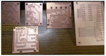

Here's a couple.
Not very clear I'm afraid, I will have to improve my photography.
I may have to find my real camera rather than my phone?
Not terribly good advertising, but it'll have to do for a while.
