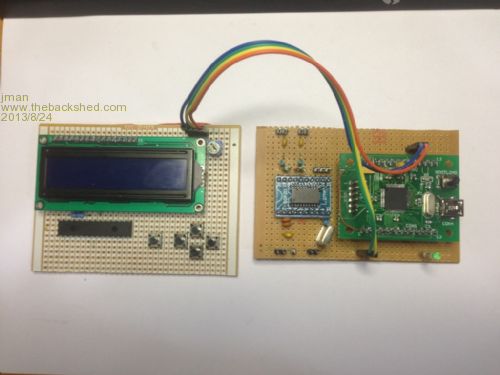

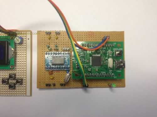

Hi
For those like to play with the electronics in their cars.
I have been working on a programable Knock Detector using a TPIC8101 from TI
This chip been programable via SPI allows us to fine tune the dectection to avoid false detection
The folowing parameters are covered
Frequency (kHz)
This is the frequency that the Knock filter module will listen for knocks at.
The knock frequency can be approximated using a simple formula:
900/(Pi * r) where r = the radius of the bore
With a bore of 76mm the knock frequency will be 7540Hz
Gain
Gain is the amount of amplification that is applied to the knock sensor signal
before it is processed. Aim to keep the Gain setting as low as you can. A setting of around 0.3 to 0.5
is a good starting point
Integration time
Integration time is the length of the sample that is processed. The times are
in microseconds (1/1000th of a millisecond).
Longer integration times will reduce the chance of false knock detection
Knock Sensor
This setting selects which knock sensor to use. Options are 1, 2
ADC Threshold %
This setting determines how ‘loud’ the processed knock signal needs to be
before it should be considered a knock event.
The setting should be around 65% to 75%
Knock Sustain (ms)
This setting can be used to ‘stretch out’ knock events.
You may want to be extended beyond the length of the actual knock.

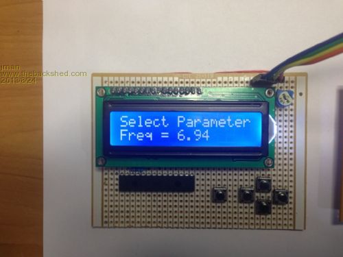

To use simply hook it up and set the required paramaters
To bring up the menu press the right button and the select button to
step through the options.
The settings are saved to file on the internal drive
Once the correct settings have been applied and tested the I2C LCD module
can be removed refer to this post for the I2C LCD details
I2C LCD
2013-08-24_060119_Knock.zip
The Datasheet for the TPIC8101 can be found here
TPIC8101
My sample MM code is attached
The code is by no means neat and tidy but it works fine
Jman
