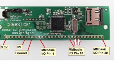

I've been away for a few months. I'm so far behind I'm just now starting to play with my CGMMSTICK1's. Time for me to move forward from the original MM. I have a nice CG color MM too, but I need to know how to connect up a RTC PCF8563 to the CGMMSTICK1.
On the original MM I connect this I2C RTC through I/O's #12 & 13 plus 3V & Grnd. I put the SDA through 12 and the SCL on 13. This configuration does not work on the CGMMStick1. I don't have a sheet for the CGMMSTICK1 and don't see a working link on the website to get one, but I think the MMIDE3 shows I/O's 15 & 16 are for sending and receiving data?
I've tried these I/O's and others and cannot get the Clocread.bas & clockset.bas programs to work. Any pointers!
I really like the CGColor MM but need to make the five CGMMStick1's I got over a year ago useful too. A RTC will do that for me.

Just a thought do you have the pullup resistors 4.7K on pins 12 and 13.

Centrex,
I do not. They were not needed on the original MM. You think that is it? I'm using a RTC that was previously on a MM and today I breadboarded it to a CGMMSTICK1. It works fine on the MM but on the CG I get a "2" for timed out.
Pete
We're all here 'cause we're not all there.
BobD
Joined: 07/12/2011
Posts: 935
Posted: 10:01pm 06 Sep 2013
Pete, I think Cliff is correct. You need pullup resistors somewhere. They can be on the Maximite or on the RTC board but you do need them. The original Maximite did not have pullup resistors on pins 12 & 13.

I'm using the same clock program that is here in the group. I just named them clockset.bas and clocread.bas. It helps me remember which is for what.
I'm using 12 & 13 and put two 10K resistors on like I did on the original MM (I forgot this was done as 12 & 13 were also used for other purposes).
Now when I boot, set the date$ & time$, load Clockset.bas and run it I get 1. The program is set for 0=Ok, 1=nack, 2=timeout. I never did understand what nack meant.
The RTC has a jumper for battery or VCC. It is set to battery like it was when this RTC worked on the MM. I also tried it on VCC and still get 1=nack.
I am a bit puzzled now. It really looks like it should work. I jumpered the resistors between both the five volt leg and 12 & 13 and then tried putting them on the 3.3 volt leg. Same results both ways. Hum...
Out of my depth.
Wouldn't the I2C addresses in the clock set/read programs remain the same for both the MM and the CGMMSTICK1? Currently it is &h51

BobD
Joined: 07/12/2011
Posts: 935
Posted: 08:46am 07 Sep 2013
  pcaffalldavis said   I'm using the same clock program that is here in the group. I just named them clockset.bas and clocread.bas. It helps me remember which is for what.
Out of my depth.
Better to use lower value resistors and / or slow the speed down to 100K.
NACK is Negative ACKnowledgement. It looks like you may connecting to the RTC but something is wrong.
Stick to 3.3 volts for the pullup
Read my first post, the address is &H51
From the MMBasic Manual (v4.4) page 48
  Quote  When enabled the I2C function will take control of the external I/O pins 12 and 13 and override SETPIN and PIN() commands for these pins. Pin 12 becomes the I2C data line (SDA) and pin 13 the clock (SCL). Both of these pins should have external pullup resistors installed (typical values are 10K for 100KHz or 2K for 400 kHz).

I just tried a different RTC and it worked first time. I must have had a bad RTC. Its battery is still good so the chip must be bad. Into the dust bin and onward! Thanks all.
