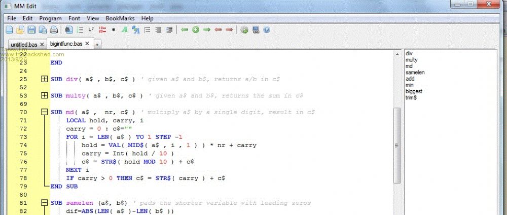

I have made some progress with the all new Windows/Linux version of MM Edit.
It has multiple tabs, code folding, function list (that's the box on the right), fully configurable colours, and colour printing.
It is taking a while to learn the differences between Windows and Linux and I really should be doing other things around the house...

Maybe I wasn't clear enough.
The current download is a small update to MM Edit. The only new(ish) bit is the ability to make a portable installation.
The code folding etc is in an entirely rewritten version of MMEdit which is still very much in Beta stage.
To get Linux, I have had to learn a new programming language as well as learn about GUIs in Linux. My previous experience with Linux has been command line only so there is a lot to learn.
I hope to have a version for you all to play with in a few weeks.
One useful (I think) addition will be the ability to drag multiple files onto the edit window.

Posts: 6624
Posted: 07:24pm 01 Oct 2013
Especially for Grogster,
Very wet and windy outside today so:
Here is a test version of MMEdit2 to play with.
You should be able to edit, format and print in COLOUR.
You can drag files onto the edit window and they will open in a new tab.
Any options you change will be remembered between sessions.
You cannot connect to the Maximite yet.
Switching between tabs does not remember which code was folded.
I strongly recommend that you make a copy of you basic files folder and play with that instead of the real files.
There is no setup required. Simply unzip to a location of your choice and run MMEdit2.exe
It is set up as a 'portable' installation so it can be run of a USB drive and will not upset your current installation of MMEdit.
2013-10-02_052338_MMedit2.zip
Posts: 10070
Posted: 09:15pm 01 Oct 2013
WOW - cheers, mate. Will check it out tomorrow and let you know.
EDIT: Couldn't wait...
Nice new GUI.
Nice new icons.
I like that the disk icon is now the SAVE icon, rather then the SAVE AS icon in the older version. Not that this bothered me at all, but it is more conventional to have the disk icon as the SAVE button, overwriting the old file with the same name.
COLOUR PRINTING WORKS!
Out of interest, Jim, was that difficult to do?
You mentioned on the other thread about colour printing, that this was not as easy as I was suggesting, so hopefully you did not spend many sleepless nights getting that to work... Edited by Grogster 2013-10-03
Posts: 6624
Posted: 10:42pm 01 Oct 2013
Most of the Icons are not mine:
http://www.famfamfam.com/lab/icons/silk/
Colour printing became do-able when I changed the programming language and someone had already done the hard work.
It also has the advantage of printing keywords in uppercase (if that is how you have the display set.
You can't print with code folded - it prints it all expanded.
Eventually, you will have the option to print/not print filename and date.

Posts: 6624
Posted: 05:19pm 03 Oct 2013
You can already add your own keywords - Help/Edit Syntax help
It was first added in V2.0 with the current system in place since V3.01
If you add words to the 'User' syntax, they are safe from being overwritten with software updates. You can also add your 'help'
Allowing users to change the Indent rules is a bit tricky.
The new version uses a different colour for user subs,functions and labels.
You can change the default colours.
You don't have to add them, MMEdit finds them for you and adds them to a list (on the right) to make moving through the code easier.
