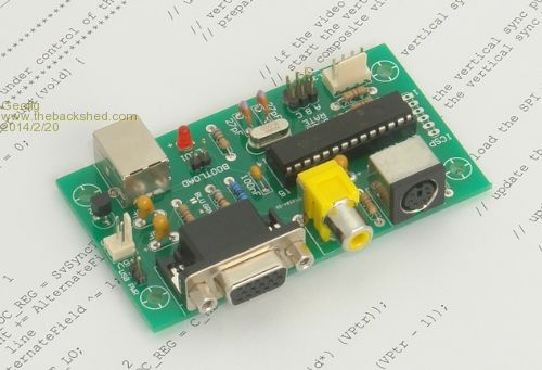

Posts: 3372
Posted: 04:17pm 19 Feb 2014
Something like this is on the way via Silicon Chip.
It uses the PIC32MX250F128 (same series as the Micromite) and has composite or VGA plus keyboard and USB. It is VT100 compatible so it will work with the Micromite's editor.
This is an early prototype. It might look complicated but that is because of the various I/O connectors.
If you wanted to design it into a project you would only use the inputs/outputs that you wanted. For example to design composite video into a project you would only need the chip plus six passive components. I have this running with a cheap ($25) reversing monitor and it is a great way to display text/graphics from the Micromite.
I have had a minor medical hiccup which has put me a month behind in schedule so it will probably appear in the May issue of Silicon Chip (editor willing).
Geoff

Posts: 3372
Posted: 07:08pm 19 Feb 2014
Oh yes, I am OK now. It was small but enough for me to miss the deadline.
The ASCII Serial Terminal will be monochrome, not enough RAM for colour.
Geoff

Posts: 3372
Posted: 12:45am 20 Feb 2014
Yes, and all the details (parts list, PCB gerbers, etc) will be on my website after the magazine hits the streets.
