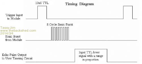

You should be seeing a 10uS pulse on the trigger terminal followed by a variable length pulse on the echo terminal.
Can you see if there is a burst of 40kHz on the transducer?
It looks like you might have a faulty unit.

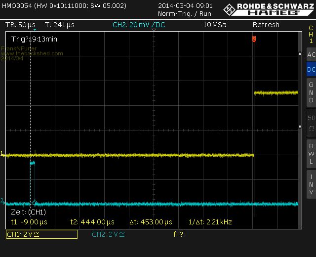

Hmmm, is it possible that the timeout of our new range command is to short?
I can see the trigger signal with 10µs and the echo AFTER 453µs!!!
I have found in two manuals that the echo should have a delay of about 250µs!
Blue is trigger, yellow is echo:
The µMite says exact in this moment "no response"!
Frank

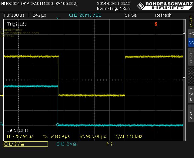

But the signals are very curious:
trigger is blue, echo is yellow, but trigger is high (no 10µs pulse) and echo is also high!
But when I change my program to:
'Ultrasonic range test
Pause 100
SetPin 17, dout
'SetPin 18, dout
Pause 100
Pulse 17, 0.01
' range = Distance(17,18)
Print "Distance =",range
Pause 60
End
can I see that the sensor works all the time without any problem...
Frank

  Frank N. Furter said  After Power Up the trigger and echo line goes very unsharp high to 5V.
You might have two issues. The first might be that the echo line is high, it is supposed to be low and the DISTANCE command checks for this and throws the error "Transducer not responding" if it is high.
The second place where you can get this error is if the echo line has not gone high within 2 mS after the trailing edge of the trigger pulse.

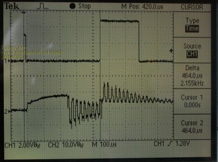

My sensor is 3 terminal so Trigger and Echo are combined on the top trace.
The lower trace is from the Tx transducer.
This was with a range of about 50mm
Colour hadn't been invented when I purchased my CRO.
You might have some luck if you attack the sensor with the soldering iron, hopefully fixing a bad joint.
