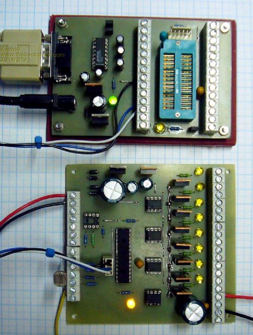

My house has a downstairs Den with my computer and television. I desire lights for the stairs. Presently lights waste power in the lounge/dining room above. The builder/woodworker/ antique-restorer who built and lived previously in the house, when adding the Den, had created for himself a polished Mahogany posted staircase as a Christmas project. Small flush mount LED lights in the wall adjacent the steps will not spoil the carpentry on the opposite banister side and are to light up only when the stairs are used.
My Micromite based system will control the 8 LED lights evenly spaced beside the stairs. “Infrared Remote Controller” sensors will serve as barrier detectors at the top and bottom approach. The two Micromite PWM outputs gated together with a resistor and diode generate the constant modulated 36KHz waveform required to drive the Infrared barrier LEDs. Approaching the stairs will trigger the lights to turn on progressively upwards or downwards depending on which sensor, and then turn off progressively upwards (or downwards) after a delay, and if both barriers are clear. Illumination is disabled during daylight as a consequence of a photo resistor exposed to ambient light level and connected to an analog input. The 12 volt lights supply may be powered down completely by the Micromite when not required, i.e. all lights off. A hidden switch will enable “Grandchildren Mode” that creates various light patterns. Remember “Kitt” from “Knight Rider”? A Console connector aids changes to the program or the light patterns and system logging. Rockby Electronics “Weekly Sale Specials” provided power MOSFETs, also dual MOSFET Drivers that boost the 3.3 volt Micromite outputs to drive the MOSFETs, Infrared LEDs and power supply control. These Drivers are capable of sourcing or sinking 1 amp at output to within 25 millivolts of the supply rails. I thought the MOSFETs and Drivers were cheap and useful; much more grunt than the lights require but the board design will also suit another project.
My friend David possessed a PicKit-3 and an account with R S Components who shipped us PIC32150F128B’s for about $5 each (with free parcel delivery to account holders) and we created some Micromites (Beta).
My photo shows the controller. The board was made using Diptrace Schematic and PCB Layout program and etched using the lazer printer toner transfer method via “Press-n-Peel”. I can confirm that Brother printer’s toner does not transfer near as well as my old Lexmark, which had a little toner left after a good shake of the cartridge. The smaller board at top is my Micromite programming and test tool with a 3 wire cable connecting its RS232 interface TTL output (2.2 volt clamped) to the Console pins on the Staircase Light Controller.

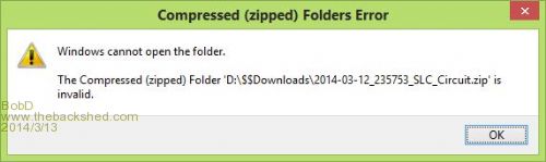

Keith, my windoze 8.1 doesn't like your zip. Bob

Yeah, file-roller from linux complains also. Is a corrupted archive?

Solved the problem! In fact is a RAR archive renamed as a zip one...

I am sorry about the non true .zip file. Thebackshed would not accept the .png image and I feared that creating a .jpg would remove some legibility but RAR had taken over my ZIP file extensions and I could not seem to create a true .zip. Renaming a .rar file to .zip could still be read (by RAR) and so I fell into a trap.
I hope that I have removed RAR’s dominance and that the file attached is actually a true .zip of a .png file.

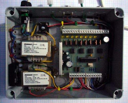

The project is installed and functioning. Two power transformers of the same type are used, for Light Supply and Controller. The Controller transformer is not optimum for power consumption but limited by availability. With taps for the voltages required I have 12 Volts D.C. un-regulated for Lights and 10.4 Volts D.C. regulated to 5 Volts and 3.3 Volts for the controller and sensors. When all lights are off a solid state relay removes power from the Light Supply Transformer; just enough current is drawn to hold on this relay (Jaycar SY-4080).
Having previously mocked up an infrared barrier detector I rashly stated that it would be an easy project, however I had problems with the detectors. I wanted to use a reflective type barrier mounted only on one side for easy installation but found that enough infrared light could be reflected from a person in the beam to prevent reliable detection. Trying to adjust the infrared level to discriminate was unsatisfactory. The infrared receiver model initially tried did not always register that the barrier was now clear although there was sufficient illumination. It could be corrected by breaking the beam again. Changing to a different model, ZD1952 $6.95 vs. ZD1953 $2.25 both from Jaycar, solved this quirk. I now have the infrared LED and the detector on opposite sides and working very well with less than 15 milliamps peak infrared LED current total for both emitters (fed in parallel). The average current is about one quarter of this due to the now 37.8 KHz carrier and 840 Hz modulation. The frequencies were chosen for the ZD1952/RPM7138 detector, one frequency a multiple of the other to aid testing.
A photo shows the controller and transformers fitted in the case. The controller is mounted below a wide step located where the staircase turns near the bottom. I had cables already with connectors fitted that have a coax bundled with 4 light wires and of the correct length for the detectors. The coax is used for the LED current to prevent this signal from possibly leaking into the detector through its cable. A Detector Circuit diagram is here.

The NE555 pin 7 ‘Discharge’ (open collector transistor) interfaces well to a 3.3V Micromite input c/w a pull up resistor. The 555 acts as a voltage level detector / driver with hysteresis, monitoring the voltage across an R C discharge circuit pumped high continuously (when receiving ) by the (PNP) inverted pulses from the infrared receiver. Constructing SMD printed boards would enable the detectors to be much smaller than the present matrix board construction.

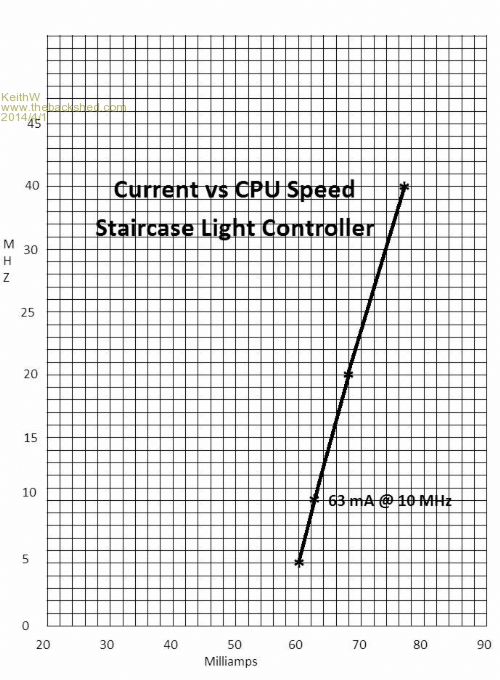

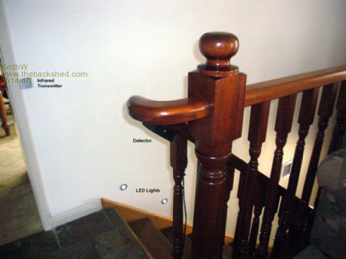

The second photo shows the top of the staircase with the infrared transmitter LED, the back of the detector box below the stair rail and the first LED wall lights. The photo is not erect but shows what is there. The graph shows Controller current vs. CPU clock speed including the drivers and infrared detectors and emitters. The LED Light Transformer current is zero when the solid state relay is off. The Micromite normally runs at 10 MHz equating to 63 milliamps @ 10.5 volts DC = 0.66 Watt. Allowing 1 watt gives 8.7 KWH PA. @ my 28c KWH peak = $2.43 PA for energy.
Interestingly the LED power indicator measures to be drawing 13 milliamps through its resistor, about 20 % of the load and the detectors another 20 %. The transformer losses swamp this; the 15VA rated transformer is (just) warm with less than 1 watt load. A power meter indicates 3.4 Watts from the 240 volts or $8.33 PA. In the distant past I could have wound a transformer with less loss. Perhaps a tiny 5 volt switching supply is required? Without improving the power supply loss other tweaking to lower the consumption is not worth the effort.
