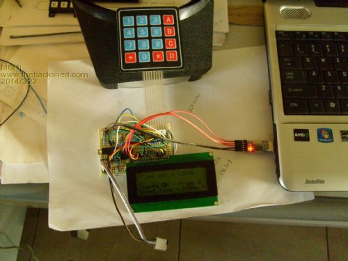

I think this one is for Geoff.
Would it be possible to amend the KeyPad command to allow a null value for the interrupt routine: e.g.
KeyPad KeyCode,,r1,r2,r3,r4,c1,c2,c3[c4].
I would like to be able to read a value from the keypad inside the interrupt routine without generating another interrupt. Either that or an "interrupt on/off" command.
The keypad function works just fine otherwise.

I don't understand what you are looking for David.
You can get the last keypress from within the interrupt routine by examining the variable "KeyCode". If you hang around in the interrupt for long enough the variable KeyCode will change to the next keypress - but spending too much time in an interrupt is not recommended.
You can also examine and change KeyCode outside the interrupt routine. Nothing special happens when the interrupt is called, all the interrupt does is tell you that a key has been pressed and that KeyCode has been updated. If you do not want to use an interrupt you can put nothing in there. eg:
KEYPAD_INTERRUPT: IRETURN
As with most things on the Maximite/Micromite, you need to experiment to understand the subtleties.

Thank you Geoff.
I have been trying to emulate a polled i2c version of the keypad and as a consequence was trying to complete my task within the interrupt routine. Believe me I do a lot of experimenting. This time, the trees got in the way of the wood.
By leaving the interrupt routine empty, I can use the keycode as you say, in the main programme or a sub. I'll post the project when done. It uses the uMite keypad, uMite lcd and i2c RTC. It doesn't leave many pins for other things. Ordinarily I'd just use i2c anyway but thought I'd try uMite hardware combo.

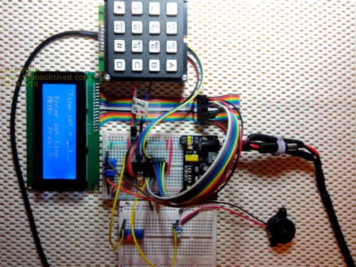

  robert.rozee said   ... and, of course, one can process a keystroke (in polled mode) then set KeyCode to an unused value (such as -1). you then just need to wait for KeyCode to change value again to indicate the next keypress - i've not tried this, but it looks fairly obvious that it should work ok.
rob :-)
It works fine that way Rob. I'm doing that on UV lamp exposure controller now I'm working on now - code below. I just set it to 99 and loop till "keypress" returns as other than 99. I also got it to assign the 99 to another variable and convert it to a string but that's unnecessary - I just haven't changed it from some playing I was doing.
The 24 pin Pic's looking a bit cluttered too you might notice, but it's handling the standard 4x4 keypad and 4x20 LCD display fine. There's also a pin being used for a lamp relay and one for a buzzer - there's still a couple left!
You can't see it on the photo but that cursor is flashing nicely and steps through the mins/secs entry as it's done and does entry error checking too. The empty line under it has the "Countdown" on it when the lamps are ON - all very well lined up now that Geoff's given us the STR$ function with optional leading zeroes - great!
The code works fine as is but it would never pass "Programming 101" . There are a heap of "naughties" in it yet that I'd like to get rid of.
Greg

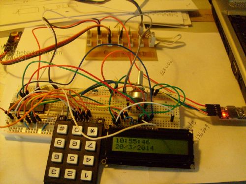

My version allows a RTC register to be selected by a 2 digit decimal number, then input a 2 digit BCD value and if the # key is pressed,(accept), the routine writes the BCD value to the register. Simple! This allows alarm values to be set as well.
David M.
MOBI
Joined: 02/12/2012
Posts: 819
Posted: 02:55pm 20 Mar 2014
This version lets you select any RTC register and alter its value via uMite Keypad. The aim was to use uMite keypad and LCD. Frankly, I'd prefer i2c LCD unless using the 44 pin Pic as not too many I/O pins are left for outside world control.
It doesn't have "time-out" facilities but that wouldn't be hard to include. As it stands, it is little more than a clock but once again, individual applications are easily enough programmed in. The main part is the ability to select and change individual registers.

My "timer" is purely that, just entry of minutes and seconds, turn ON, countdown, turn OFF - break countdown if wanted. Good for up to 99 minutes (or more if program is modded) and with one second accuracy. No real-time involved.
I've tidied up the code a bit (below) but if anyone wants to show me how to do it much more neatly I'm all ears. It's working OK but there's a couple of bugs. For some reason I have to press the 'D' key three times to return to MENU and the 'B' key twice to start the countdown after having already counted down the first time. I also get a "Not in interrupt" error occasionally which bombs it out. Any ideas gratefully appreciated. Here's the "tidied" code.
Greg

Posted: 09:45pm 21 Mar 2014
@ Greg,
As you can see, I got the jungle running - not pretty but it works.
I got your programme in and yes, it does do a few quirky things and hangs up/ bombs out etc.
I had never heard of the TRF foil. It look like the cat's whisker for fine PCB traces. Pity my laser mono is a Brother and the toner will not iron onto blank PCB no how. Never mind, Kinsten, NaOH developer, and HCl H2O2 etchant works for me - no "big bangs" here so far.
Now, on to the programme...
