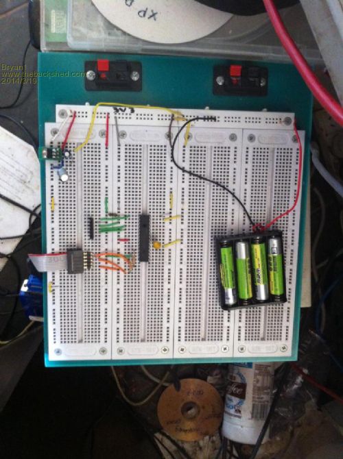

Now as you asked a pic of the Breadboard
At the top left is the 3V3 power supply comprising of a TLV11173v3 reg with caps which go to the left top rail. The right top rail is for the 4 AAA's I use as the power supply.
I have checked every power and gnd connection and everything is true.

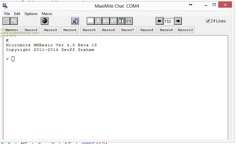

Well no new dongle at the PO and as Grogster has said it does look like the data isn't being inverted. Now for the first time I got the pic connected to MMChat and below is the output.
So now off to the shed to hook up an inverter chip and see if that makes a difference.

MMChat works fine for my MicroMites, provided you set the port up correct.
At this point, I have to agree with the Wizzard, and be very suspicious of the USB serial lead.
My example photo above, is using one of his 44-pin boards, but he has intergrated the USB serial port on the PCB, but this is still my results via USB.

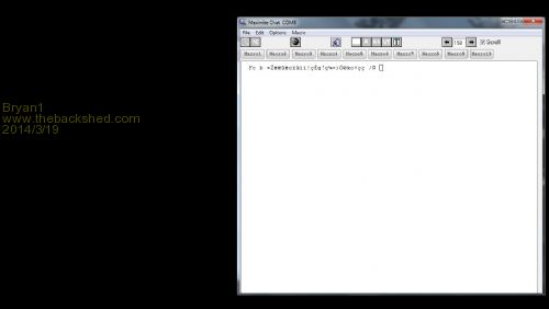

Ok got a 74ls04 chip hooked up and now no output to teraterm or MMChat. I tried in my shed with the fluke and the inverter is working too. I tried on this computer too and programmed a new pic with the same result. So it does look like I'll have to wait for that new one to turnup. The pic's I'm using are pic32MX150F128B-50 too.
When I shorted out the usb output I did get characters echoed and when I did a reboot I got that garbled text in MMChat. This was before I put the inverter chip in.

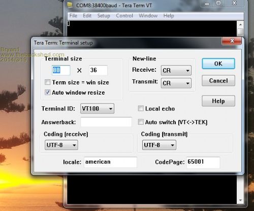

One last thing worth trying:
In TeraTerm, select 'Setup' tab, then 'Terminal'. Can you please grab a screen shot of those settings and post it?
Thanks . . .

As requested here's that screenshot
Now I put another inverter in this time a 74HC04 and on doing voltage checks found the output from the serial dongle on pin3 was -2.49 volts. I am running the inverter off the 3v3 rail too as I found when setting it up on the Vin rail the output was 5 volts.

Bryan,
In your photo, it looks like you are using a USB to serial converter, not a USB to TTL.
The blue thing-a-me-jig almost hidden with an IDC cable coming of it.
If your converter has a moulded plug with a DB9 connector on it, it is RS232 serial and not TTL so inverters are needed.
A photo of your adapter will confirm this.
