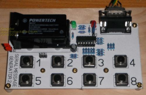

Perhaps you need a serial message generator?
I made one of these, and it makes testing so much easier, if you can generate "Fake" messages with which to test with...
This is based on a PICAXE 14M2, and you can program it to output any message you want, on any of the 8 buttons - I have the coupled to the Colour Maximite at the moment, and I can send it any one of 8 messages any time I press a button - also useful for sending multiple messages, and seeing how the MM serial buffer deals with it.(very well, actually!)

Posts: 2998
Posted: 11:37am 23 Mar 2014
Hi Grogster,
Nice little gadget you have there although Geoff would be very disappointed that it isn't based on a MicroMite!
So is it your own design? If so I would like to include the concept in a collection of 'MicroMite projects' I am compiling.
Let me know . . .
WW

Posts: 10100
Posted: 01:01pm 23 Mar 2014
@ Nixie & WhiteWizzard & anyone else interested:
Yes, I designed and built the serial message generator myself a few years ago. I used PICAXE, as that was what I was into at the time. A MicroMite version would be easy to build though, and would be the chip of choice had I to build it again now. I would also replace all the throuh-hole parts with SMD - using the SOIC MicroMite chip, and 1206 SMD resistors etc.
I have OFTEN found, in my playing around with serial, that it is really handy, if you can just press a button to send a "Fake" message while you are trying to perfect your code. You could always use a laptop and serial program to do the same thing, but this is much smaller. I also have my laptop hooked to the other MM serial port, as when I press a button, the MM process the message, and then outputs a corresponding message to a pager transmitter on the other port, so at the moment, I am using the laptop and terminal software as a pager transmitter mock-up, to make sure the correct data is both going in and coming out.
I have been able to test my message system on the MM, by pressing ALL 8 buttons one after another in quick succession, to fill up the MM serial buffer, then watch what the MM and how my code deals with it - nice easy way to build a message queue, if you are testing message queuing, which I am. To say nothing of the fact that with a laptop instead, you have to type the message, having to just push a button is much quicker.
I can upload gerbers and PICAXE code, if anyone is interested in making their own one.
