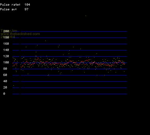

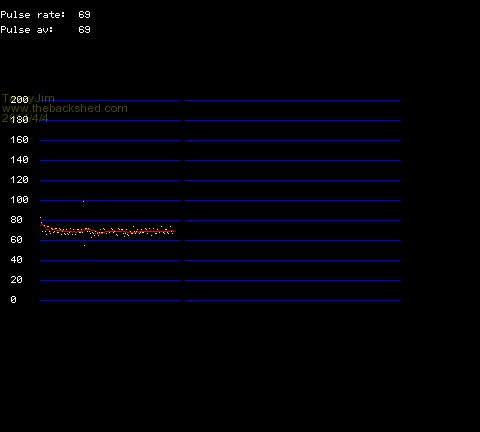

A few months ago I decided to make Maximite Monitor which could chart the heart rate and give me a realistic indication of how hard I was exercising.
I purchased an ear clip type sensor from seedstudio as it came with electronics to output nice pulses for the maximite.
My first attempt was a failure because the output was all over the place. It made no sense at all.
I had an ECG a few days ago and the good news is - my first attempt at programming the monitor was correct after all!
The bad news is the same - my Maximite monitor is right - my heart beat IS all over the place.
For the technically minded, I now have Atrial fibrillation.
The man in the white coat has sent me to another man in a white coat so it might be a while before I know what options there are but in the meantime, the Maximite Monitor will be there to keep an eye on things.
My next project will be to use a micromite to make a portable recorder so I can see what happens when walking uphill.
I also want to investigate the chest strap type sensors. There appears to be some that use Bluetooth and other 2.4GHz and a couple of different 'standards' to sort out. I have ordered one that has a receiver that plugs into the audio input to your iPhone so I am hoping that I will be able to get usable signals that way.
The code charts pulse rate (in yellow) and a running average of the last 12 pulses (in red). The running average was needed because of the erratic nature of my pulse.

The first screen dump is from a 'normal' heart rate while the second one is mine.
