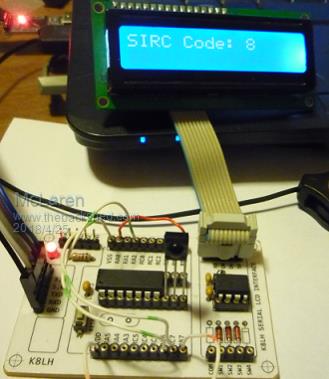

McLaren
Joined: 28/06/2011
Posts: 11
Posted: 01:00pm 25 Apr 2018
I'd love to see pictures of how you guys implemented this little backpack design. I didn't do much with it except to put it on a little 8-14-20 pin development board (picture below).
Cheerful regards, Mike McLaren, K8LH (Michigan, USA)
Edited by McLaren 2018-04-26
