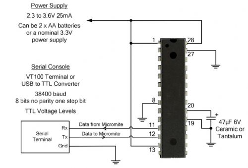

Hello
Apologies if this is not the right place. Have just bought Micromite from Silicon Chip, and wired up per basic instructions, using a polulu USB/Serial converter. Proved that is OK by looping TX and RX.
No MMBasic announcement or command prompt. Current draw at approx. 3 volts just 4 mA. Any ideas? Possibly a blank PIC and not pre-programmed at all?

Hi Herry,
I assume that you are using TeraTerm.
1. You will need to set the correct port & baud rate in TeraTem. Open TeraTem then click on > Setup > Serial Port. Select the correct port for your adapter. Then set the baud rate to 38400. The serial port can be any where from Com1 to Com16 or higher. If you are unsure then look in Device Manager under "Ports".
2. Make sure that the RX & Tx from the Serial Adaper to the Micromite are not reversed.
I have seen some adapters where the RX pin marked on the adapter is actually the output.
It is highly unlikely that you received a blank chip.
Let us know how it goes.

with Rx and Tx connected together, check the voltage to ground. it should be either 3.3v or 5v. as keys are pressed, it should 'flicker'.
if it is -12v, you have a usb to serial bridge with built-in line drivers. this is not suitable. if it is 0v, then the signal polarity is inverted and you need to add in inverters (or find the software for your bridge to change the polarity of Rx and Tx).
if it is 5v, you need to add 1k resistors in series with both lines - strictly speaking you only need a resistor in series with the line running to the Rx pin on the micromite, but it does no harm having resistors in series with both.
if still no luck, try swapping round Rx and Tx. even if correctly marked, it is easy enough to get confused and reverse them.
please do report back your findings!

that is a good sign... lets look at the micromite itself again.
4mA strikes me as a little bit low, as if the chip is either un-programmed or being held in reset or some such. have you got it wired up correctly; are you 100% sure?
GROUND: pins 8, 19, and 27
Vcc: pins 1, 13, and 28
(pin 1 may be tied to Vcc via a 10k resistor)
Is the capacitor connected between ground and pin 20? Pin 20 should ONLY connect to the +ve terminal of the capacitor, and to nothing else. Pin 20 should NEVER be connected to Vcc.
i believe you should be able to measure something like 1.8v across the capacitor.
if a micromite is functional and programmed correctly, one test is to connect an LED between pins 11 and 13 (longest lead to 13). when power is applied the LED should briefly flicker brightly as the 'signon' message is transmitted by the micromite. all you need is power for this test, no serial connection.

OK! Firstly what voltage do you see there? I would be very surprised that it is exactly zero..
This is the obvious point of there being some problem.. I just checked with one of my chips and I see around 1.8v with BOTH a programmed and a BLANK Pic chip across C1
If you are seeing nothing as in 0v then I suspect a wiring problem..
Check that C1 is connected (using a meter), +ve (the side with the line if using a Tantalum) to pin 20 of the pic32 and -ve side to pin 19 of the PIC32.. Also check that there is no short across the capacitor..
Now you may be aware of pin numbering but just to be sure this picture shows the pinout clearly.
Your Avatar says you are in AUSTRALIA, are you in Melbourne? I am happy to assist if you are local enough.

I have a blank chip here and when connected per the diagram the voltage on Pin20 is 1.8V. A reading of zero volts indicates either a supply problem or possibly a shorted cap. Remove the cap and measure again. It should also be about 1.8V. If still zero volts. Then take the following measurements. Measure directly across the Pins with the Gnd lead on the first Pin and the Red lead on the second pin. Do not attach the meter gnd lead to the gnd rail.
1) With the Cap removed & power connected .... Measure from:
Pin 8 to Pin 1
Pin 8 to Pin 28
Pin 8 to Pin 13
Pin 27 to Pin 1
Pin 27 to Pin 28
Pin 27 to Pin 13
Pin 19 to Pin 1
Pin 19 to Pin 28
Pin 19 to Pin 13
These should ALL read 3.3V. If not then check wiring until corrected.
Once corrected .... or if all good then ...
2) Connect the cap between Pins 19 & 20 with the + side of the cap on Pin 20
Take the readings again. All should still read 3.3V
3) Read directly across Pins 19 & 20. It should be 1.8V
Make sure that breadboard rails are jumpered properly. Some breadboards have segmented rails ( breaks between the red lines). These breaks need to be jumpered for the rail to extend all the way across the breadboard.
Make sure that the GND on the Serial adapter is tied to the GND gnd on breadboard/Micromite chip.
If all of this does not lead to a solution, then the chip is likely blown.
The only defective PICs I have ever had were "defective" because I accidentally applied either too much voltage or accidentally applied reverse voltage. This usually resulted in the chip drawing excessive current when proper power was applied.

Well, egg on face department speaking!
Thanks chaps for all the help. I received from Silicon Chip magazine a replacement chip and...that didn't work either! By now thoroughly bamboozled, I tried replacing everything, even the patch leads one by one. When it got to the project board BINGO! It was the *&$# board all the time! Can't remember where I bought that particular board. Wish I could! So all OK now. Thanks again all of you for detailed and great help help!
Duh department signing off and looking for the 'RESOLVED' tag!

Yes, I did try the original chip and that worked too, so I'll purchase the new one (not send the old one back as invited). The problem with that particular breadboard was that the contact strips were too far down into the plastic, so the pins of the Micromite did not reach them.
Thanks again all! No doubt I'll be back!
