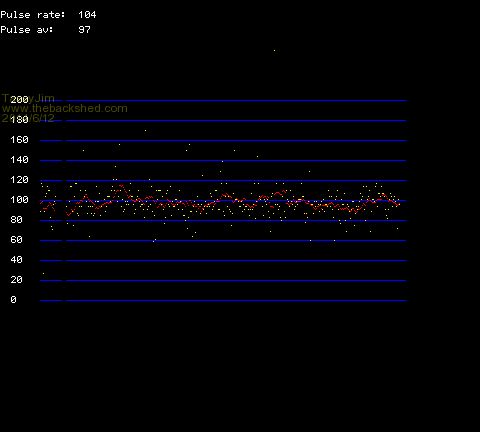

I have had reason to take an interest in my heart rate lately.
The usual chest strap types and Android apps tended to give average readings and I am more interested in the variability.
Maximite to the rescue.
' pulse monitor for colour Maximite
' 12 June 2014
' TassyJim
' pin 21 connected to the pulse detector.
' www.seeedstudio.com/depot/Grove-Earclip-Heart-Rate-Sensor-p- 1116.html
' pin 12 used as an output to LED or CRO etc.
' P print screen to PULSE.BAS (will overwrite any existing capture)
' C clear screen and start again
' L start logging data to file (will append to same date file)
' X stop logging to file
' ^C to quit.

The code is for a colur Maximite so the colours would need to be changed for the Mono Maximite.
Example for April:
The yellow dots are the instantaneous readings and the red is the average over 12 pulses.

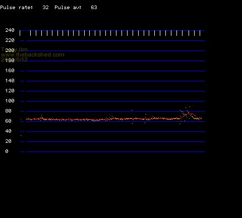

I was booked in for an electric shock treatment today but after they plugged me in, they discovered that things were back to normal so no zapping today.
Today's trace:
The blip at the end is when I reached down for the keyboard.
Yesterday's trace was more like the first one so whatever happened to fix it, happened last night.
The cardiologist doesn't really like the idea of a Maximite diagnostic kit but I might try him with a couple of printouts next week.
