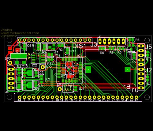

Well, I think I'm getting to the done'r side of things on this PCB, and wanted to possibly get some feedback from you fine folk before any ordering goes down...
It was produced on the DEX package Big Mick told us about. It is made to fit just behind the 2x16 LCD display, same size, (80x35mm) with matching mounting holes. RTC and Temp IC's are on board, and I was thinking of adding a LTC2631 DAC chip...
If so, I wanted to check with the IIC guy's out there as to properly get the REG addressing correct as to not interfere with the RTC. Also is the question of the REF voltage. Is it ok to use +5 volts for DAC power and REF pin input..? The RTC chip is running off the 3v battery. I'm not sure if the pair can work correctly at the 2 different voltages... Probably not... any feedback would be a big help for the layout...
During the design, we were careful not to use any of the multifunction pins for internal devices. I did manage to have enough room to use the CR2032 (20mm) coin cell with the Harwin socket. It is mountable from either side of the board, so if you back mount it, you have a good amount of topside for an extra IC part... Hence my thinking of the possible DAC chip... Any other ideas..?
Also, will be spinning up a bottom "sea-o-holes" board to go with it and offer it up as package on Phil's website...
Attached is the "info" pack for it...

Feedback always welcomed...

Hi Zonker,
your circuit looks very interesting to me.
Your file "2014-06-12_030421_PIC32-44pin_LCD-Prototype.zip" doesn't work - my reader says that the included PDF is corrupted...
Frank

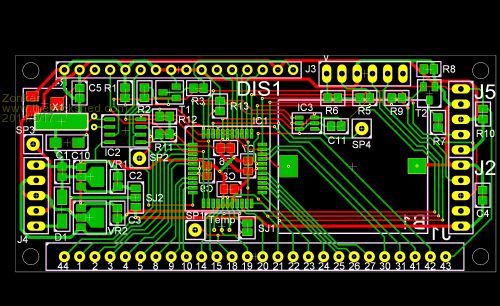

Well, I decided to go with a Microchip DAC instead... But again I want to check with the IIC guy's out there... As far as I can tell from the PDF file, the RTC chip uses the address "A2" for write operations, and "A3" for read operations....
The MPC 4725 DAC chip uses a combination of a "device" code (upper 4 bits set to 1100 (C hex)).. the next 2 bits are "hard-set" from the factory when you order the IC, and the last bit is controlled by the A0 pin on the IC...
When I order the part, I was going the get the one with the factory bits set to 00, so the part will have a slave address of C0 or C1 depending on the A0 pin... As far as I can tell, this should not contend with the RCT addresses... Also, the RTC is only read every once in a while, so much of the time, there wouldn't be address conflicts anyway... (I think)...
So, just to be sure, I wanted have somebody check this over and see if my thinking is right... Thanks for any feedback..!!

Hi Zonker,
the RTC uses the 7bit address h51 (hA2 for write and hA3 for read operations).
The MPC4725 uses the 7bit address h60 or h61, independent from A0 (with factory setted A2=0 and A1=0).
The LTX2631-Z uses h10, h11, h12, h13, h20, h21, h22, h23 or h30 independent from CA1 and CA0.
There should be no address conflict between any of these chips...
Frank

Good evening Gent's... Dumbass here....
It seems that I posted the wrong DAC file, as I have the board setup for the MCP4725 DAC from Microchip... The PDF is to big to load here but we ended up ordering some test parts anyway...
@Frank... Thanks for the info fine Sir... Would it be ok if you take a look at the "correct" data..? This IC seems to have a device code of 7 bits... The upper 4 are set to "C", the next two are set when you order the part, (we chose "00") and the last bit is controlled by the A0 pin... So, if I ground the A0 pin, we get "1100000" as the device code... Hope this works OK...
I know "zip" about IIC stuff... Could you give some simple "init" code for this guy..? just want to write some board test code when it ships out to people... I want the board to boot-up, announce itself on the LCD display, and test the onboard hardware for it's new user...
I got the DAC onboard... Starting cleanup... Parts sizing test soon...

Posted: 08:12pm 16 Jun 2014
Hi Zonker,
you are right. The address should be h60 (b1100000) with grounded A0, I've loaded the correct datasheet yesterday...
I haven't any code for this device but I found BASCOM code for it:
BASCOM Code
and here is the link for the translated site:
BASCOM Code translated
(I hope the link works)
